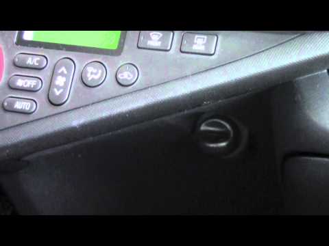

    There is only ONE 12-volt outlet - on the front dash, centered under the radio.

    Thanks. I also have found a similar drawing on p. 333 of the manual, under "power outlet". I haven't decided on a handheld vac yet---I'll probably get one that's good for inside my apt. too, not just "automotive".

    The 12V outlet is deactivated when the car is turned "OFF". Therefore to run your 12V vac you will need to turn the car "ON". But you won't be able to run a very powerful vac from it. I suggest getting a 115V vac and an extension cord.
