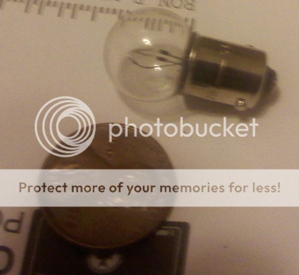

    Thanks, Chap, I guess I instinctively avoid Toyota dealers because I have that "dealer = expensive" mentality. But, of course, if I can't find it online, it seems perfectly reasonable to go where one can get them AT ALL. I will do that.
    BTW, this is what they look like, in case it jogs anyone's memory.
