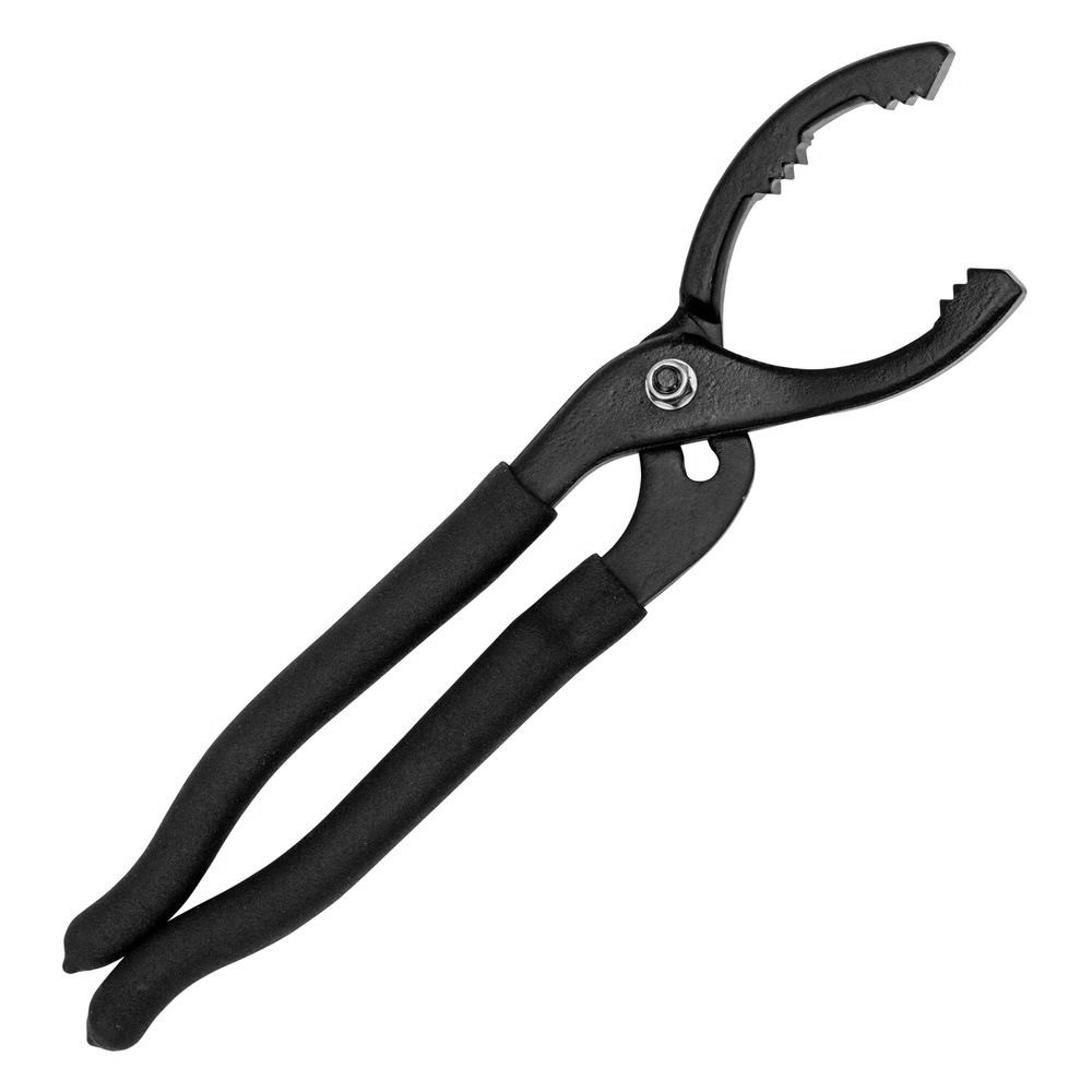

    Hello, can I use this oil filter plier that I already have to change oil for my 2010 Prius?
    Or I'll need to buy something like this to take off oil filter?
    Thank you so much!

    Barbaric plyers. You will need to purchase the stated filter wrench to remove the oil filter canister. (y)

    I do have a pair of pliers somewhat like the OP's first pick: they work great in the kitchen, when I'm struggling with a jar lid... :oops:
