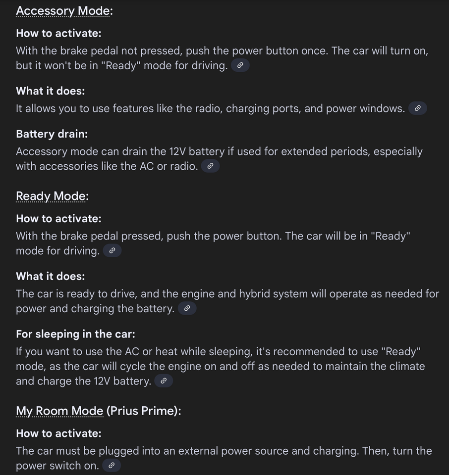

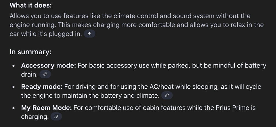

    Here is a good summary from google ai.
    IABoy987 likes this.

    Thanks for the list.
    I had not read of My Room mode or missed it in the owners manual. Not quite sure where it might be used (at a campsite with 120V outlet nearby??)

    My uses for it are:
    1. keeping the car internal temperature cool to allow electronics inside (ie my Anker Solix) operating at below its max temperature.
    2. Sitting in the care while plugged into a charger and using the 12V outlet to power a laptop computer and Starlink.
    3. One other advantage of room mode is it continually draws power from the charger so if you need to maintain a charging state to park in certain parking spots it will keep the charge from completing until you return to the car and turn it off.
    4. One other use would be if you want to charge your car but will not be around to unplug it when it is done and are worried about draining your 12V auxiliary battery you can turn off most of the interior electronics (ie media screen, climate system) and the automatic headlights. Room mode maintains the 12V auxiliary battery charge while plugged in to the EVSE.
