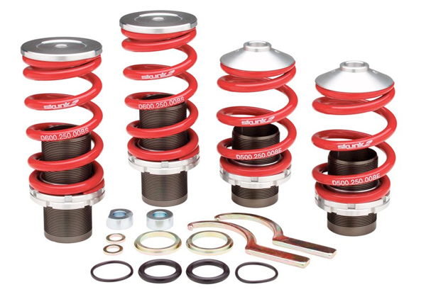

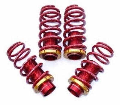

    ~$350 Ground Control - Spring Rate: Moderate - maintain closer to stock (saying this modestly) ride as possible.
    Part #:8070.01
    ~$272 Skunk2 - Spring Rate: Harsh - much stiffer ride.
    Part #:517-08-245
    Not many if not only one person has done this mod, so asking this question may be a shot in the dark...but give me some opinions and why. Thank you!

    I was thinking of the Skunk2 because of price and I don't mind losing comfort for better handling.
    Staying w/ stock shocks for now.
    I provided part numbers because I haven't found the info your asking about yet.
    These are adjustable Coilovers sleeves...
    GroundControl Part #:8070.01
    Skunk2 Part #:517-08-245
    The issue is height, Coilover sleeves will allow me to go much lower than the available springs I've found. 1.4"F & 1"R isn't gonna cut it. Especially in the price range of either of these sleeves.

    Ken@Japan said the below specs about the spring rates- (Not sure how to convert newtons or really what this means)
    Touring Prius front=24N, rear=28.5N (5.39/6.29lbs ??)
    Standard Prius front=24N, rear=30N (5.39/6.74lbs ??)
    GC website doesn't even say what the rates are but it looks like you can request whatever you want...:
    Ground Control - Coilover Conversion kit, 03- Toyota Matrix/Vibe
    Skunk2 - Spring Rates F/R - 446/335 lbs/in
    Skunk2 Adjustable Coilovers Toyota Matrix 517-08-2450

    Couldn't find much about the Skunk2 Springs except - Spring Rates F/R - 446/335 lbs/in, I know that GC uses Eibach springs with custom rate of springs but nothing other than that.

    Not sure what springs Skunk2 are using but I was at least able to find the spring rates...

    I'm fully aware that "coilover" doesn't mean "just springs" - which is why I also said these were coilover sleeve options.
    Had this been a completely lousy choice for "Toyotechwv" in chosing them for AutoXing, I probably wouldn't have looked in this direction. However, with stock front shocks (because of whats available in this $ range) and the option to upgrade with Tokico rears, w/o spending almost twice as much for a full matched pair as suggested, this seems like a valid choice. IF after this has gone thru rigorous testing and hasn't proven itself worthy, I'll upgrade to a Full Coilover Setup and choose between the currently available options of the Megans for $880, the TANABE Sustec PRO-NF Coilovers for $1000, the TEIN Super Street Damper for $1670 or the HKS Hipermax LS+ coilovers for $1900.
    Until then the $443 setup w/ Skunk2 sleeves and upgraded rear Tokico HPs will suffice.

    WTH.... discontinued!?
    Looks like I may have to go with the GC as it seems Skunk2 isn't stocked by anyone and drop shipped directly from the MFR who has discontinued the item.
