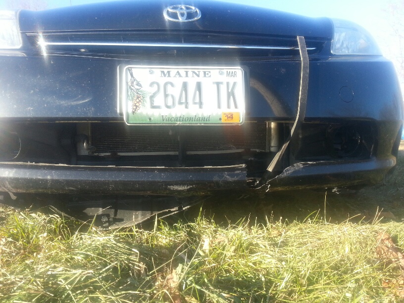

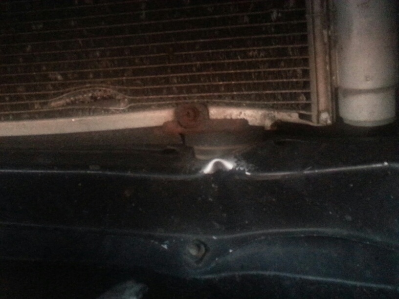

    I drove into a pile of wood and was lucky enough to damage a radiator. I can't tell if it is the a/c condenser or the actual radiator. It is the one in the front. Also, what would be involved in replacing it? It looks like I'm going to need a support and all the plastics as well.

    I know its December in Maine, but does the A/C still work? The damage looks like a bend, but is there an actual rupture in the tubing? That is indeed the A/C condenser. It would require professional assistance to repair, and likely a new Toyota condenser. Some after market condensers are inferior, according to one of the PriusChat A/C gurus.

    I wish I could test it, but it's -17 degrees (f) outside right now. It is dented and banana'ed pretty bad, but I can't see any rupture to speak of. I have no clue if the refrigerant would make a "liquid" stain on the aluminum, but I don't see any. Is it okay to drive with a leak in the a/c condenser? I usually make an attempt to turn off the a/c (prius loves it to be on 24/7 for some reason), but I don't want to screw anything up.

    Did you break your fog lights too or is that just the spot where they could go if you had them

    No fog lights. I never knew those were there, if so, I would have bought the assembly to add fog lights

    If there is an actual leak, you might see an oil spot in the bent area, and after a while it will accumulate some dirt and dust. The refrigerant will escape as a gas. The A/C is useful for defrosting purposes in cold times, but not essential.
    I would leave it off until you can get a feel for how bad the hole might be, and it is possible you are lucky with no hole. Not sure what you mean about the A/C being on 24/7, just toggle the A/C button on the Climate screen, and the A/C will stay off. I don't use the auto climate control.
    That condenser needs cleaning for sure. Hose it out and clean the debris at some point, and it will work better.
    If you know someone that knows how to put a set of gauges on the ports, it would be possible to find out if there is anything left in the system.

    Just meant how it defaults to being on when "auto" is selected. Looks like the A/C does still work, I brought it into a friend's heated garage and it definitely still blows cold. I'm probably just going to replace all the plastics on the front bumper for now.
