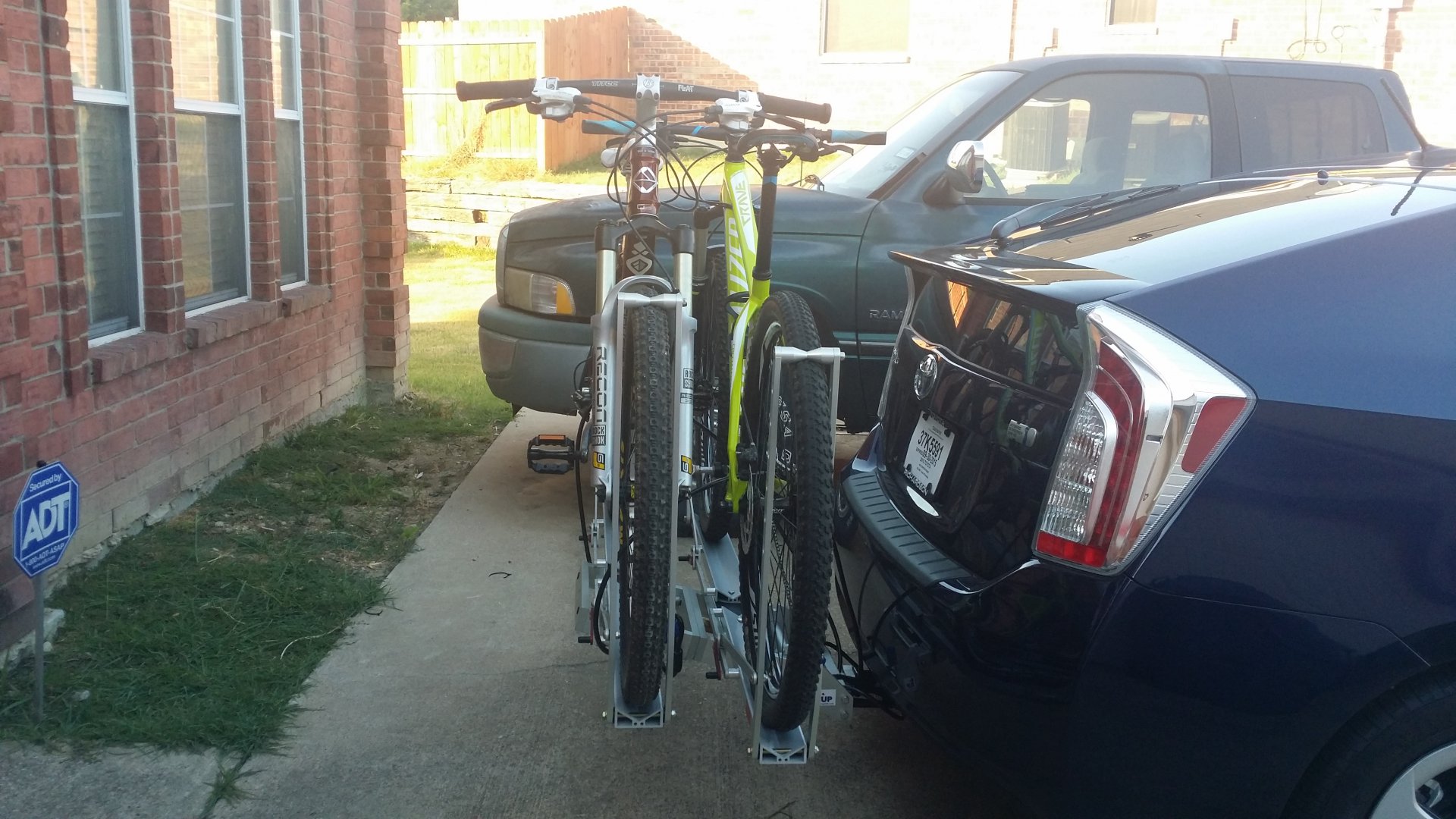

    My vote still goes with hitch mount rack. Way easier to load and unload...and no damage. Curt 1.25" receiver and 1UP USA Single Quick Rack with a Quick Rack Add On. Even installed the trailer harness for lights...which have been used pulling trailers. ;)

    In order to install the hitchrack (for gen4) needs to be installed the adapter by a car center. While the roof rack is easy.
