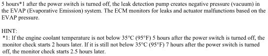

    It wasn't going for a few hours, and it didn't shut off randomly. That's the leak-detection pump for the evaporative emissions system, and it runs in steps B, C, D, and E of the self test, which starts about five hours after you park the car (sometimes delayed a bit longer, in extreme temperatures).
    Step C is the step whose time is variable, so the pump will be on for roughly between seven minutes and 22 minutes, depending on how long step C takes.

  5. ChapmanF
    27,661
    18,250
