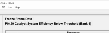

    As far as I'm aware, the P0420 does not have subcodes associated with it, at least for a Gen2. It does have freeze frame data.
    Trouble areas are listed as :
    Gas leakage in exhaust system
    A/F sensor (bank 1 sensor 1)
    Heated oxygen sensor (bank 1 sensor 2)
    Three way catalytic converter (exhaust manifold)
    I think I have a Gen 2 in the family that has an intermittent P0420, but I haven't dug into it yet. Maybe I can connect up with it this weekend and post a photo of the freeze frame.

    Yes it was a typo, sensor 2 meaning downstream on the Cat. Unless someone can show you their tech stream screenshots you're not going to get the answer you like.
