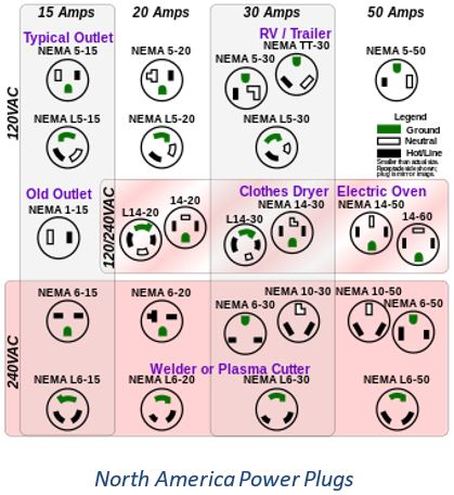

    Chris, tell us about your Garage. Do you have any existing 220 outlets there? (My garage is out of the ordinary as I have 6 220 outlets, 2 of them 3 phase)
    Dryer outlets? etc.?
    The Prime only uses 16 Amps of a 20 Amp circuit, so I installed a NEMA 6-20 for my daughters' Prime, but NEMA 10-30 and 10-50 are common and if you have one, great! Once you find or install a 220v outlet, you can find a cord that matches that spec.
    WWW.amazon.com/Zencar-100-240V-Portable-Electric-Compatible/dp/B075GJK2S9
    This link is to a charger that uses NEMA 6-20 for 220v and NEMA 5-15 for 110v But if you notice, it comes in many other flavors of plug. So step one is to look for an outlet that already exists. (ideally your service panel is clearly labeled) Any Electrician can put in a 220v outlet or 2, ideally Ground Fault Circuit Interrupter protected. With luck there is room in your existing service panel. As you want to charge in the dead of night to get the best electrical rates in CA, the car charging will not happen when you are cooking, drying clothes, running A/C, etc.
    Each service panel uses unique circuit breakers for that panel, (my daughter has a Square D QO load center, so I used QO breakers) so I can't give you detailed parts, the electrician will price out Breakers, Romex wiring, and receptacles.
    The nebulously named Shop 220 at 14 and 16 turned out to already be in her garage, so I did not need the breaker I bought.
    www.amazon.com/Square-Schneider-Electric-QO220GFICP-Qwik-Gard/dp/B00DW472XE
