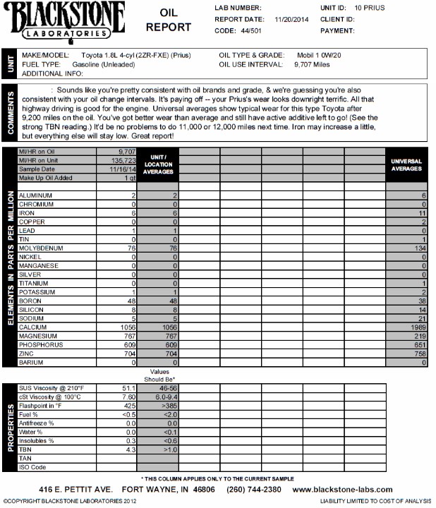

    Here is my Blackstone Labs report from last oil change in Nov. Previous change was in Aug.
    Clock was at 135723mi with 9707mi on this oil.
    I have been using Mobil1 0W-20 Extended Performance 15K for the last 3 oil changes.
    OEM Toyota filters from local dealer.
    I check the oil every week or two & top up when it is 1/4-1/3 qt low keeping the oil level at, but not above the full line.
    The engine will use ~1 qt of oil during the 10K oil change interval.
    My next oil change will be the end of Mar or in Apr. I'll probably let it go close to 12K & send off another sample to Blackstone Labs & see what they have to say.

    KC410- that is such a beautiful squeeky clean UOA, it brought a tear to my eye! (y)(y) That engine is going to outlive YOU, lol.
