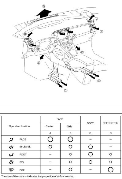

    Well, there are two heater vents under the front seats, for heat.
    The two vents in the middle of the dash should be pointed slightly up to cool the rear seats when using AC. The two side vents should be adjusted to not freeze the front seat occupants. It doesn't get that hot of here but that configuration works well for us.

    Set the mode to divert air flow, maybe heat/defog? This'll save you getting hit with all the coldest air, and pump some through the underseat duct to rear zone, as well.

    The rear foot registers are not only there for heat, but for A/C as well. Any airflow, regardless of temperature, for that matter.

    I set the A/C to bi-level and it cools the rear passengers just fine. With a little adjustment to the dash vents to direct the air flow to the rear, you'll soon have the rear passengers complaining that it's too cold. It's all in the way you adjust the vents.

    If you are in Arizona, no one either in the front or the back could complain it's too cold, period.
    When you adjust the dash vent toward the rear, the front driver and passenger will not have enough cold air in such hot climate. The OP is asking for extra vent in the back to supplement the front vent.
    The under the seat vent is too far away and not directed to the rea passenger, by the time the cold air reaches the rear passenger, it is warm air already.
