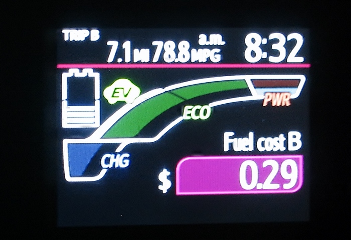

    It all depends on what you want to know. If you want instantaneous information above 99.9 mpg, you will need an OBD reader such as a Scangauge. Mine, by the way. shows differing mpg readings (up to four digits) while coasting depending on the speed and whether ICE is turning or not. For instance, one of my favorite readings is when ICE is spinning at 992 rpm (but not burning fuel) and my Scangauge shows mpg as 9999. This happens when speed is above 43 or so mph and I'm pure coasting down an incline.
    If you are interested in what your mpg really is above 99.9 for a finite distance, you will have to do some calculation at the pump when filling up or, alternatively, using the eco saving screen. Having input the correct cost of fuel, one can calculate the mpg above 99.9 mpg.
    This is the eco-savings screen
    This is too short a distance to provide an accurate number. I'll try to provide a better example later, but am in a hurry now.
