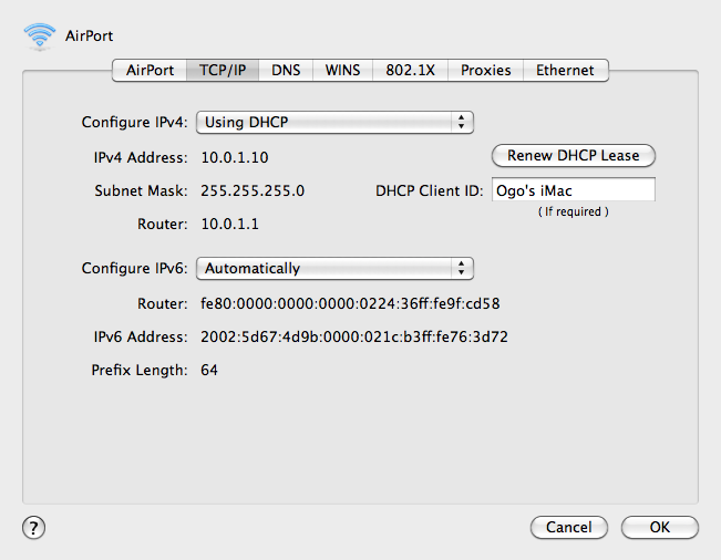

    Well I am an IT guy and I buy Apple hardware for my home use.
    Maybe because I already grow too much gray hair during my working hours and I want to enjoy my free time using stuff which simply works. :rockon:
    Currently connected clients:
    Signal conditions (up to two steel reinforced concrete walls between clients and base stations):
    IPv6 out of the Apple box:
    IPv6 connectivity tests, ping6 & traceroute6 to ipv6.google.com :
    Ogo
