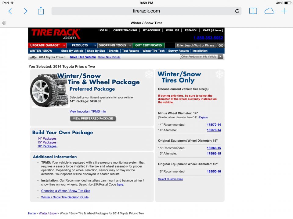

    I just found TireRack.com gives the option of ordering a 14 inch wheel/tire.
