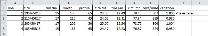

    Toyota sells the 3rd gen Prius with standard 195/65R15 or optional 215/45R17. The latter's size is pretty close to what the 185/65R15 the OP's considering:
    (These numbers are just theoretical, based on stated size. Actual numbers vary a bit.)
