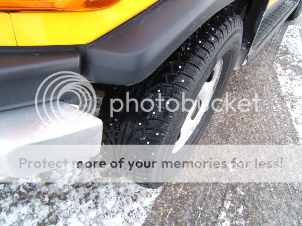

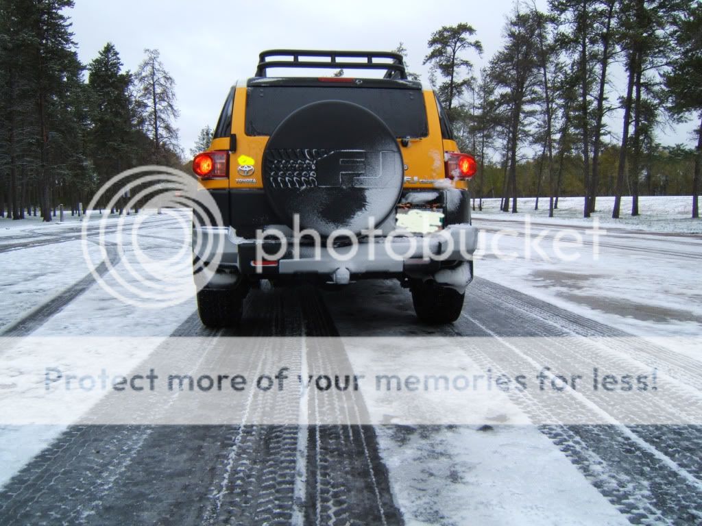

    My '04 Prius had the hyper-sensitive traction control. If I was caught by surprise with the Michelin Harmony tires on, when the light turned green the car would remain motionless. Studless winter tires helped, studded winter tires cured the problem
    I run dedicated studded snow tires on everything, including my FJ Cruiser. Amazing how handy that extra traction is when some fool on "all season" tires slides through a red light or spins out in front of you

    1. Two sets of tires/wheels is really no more expensive than just one set, as the wear is spread among 8 tires instead of 4
    2. I always interchange snow vs winter tire. Virtually every modern snow tire has the special compound: the Nokians, the Goodyear Nordic, the General Altimax, etc. The studs really make a huge difference on ice. They claim studless tires are as good if not better, my real-world experience proves just the opposite
    3. Studded tires were banned in Ontario for almost 3 decades. They really couldn't prove that road wear was the result of heavy traffic or just studs. After highly public and sensational news stories, and lawsuits, the MTO relented and finally allowed studded tires.
    But only in Northern Ontario, eg Sault and north.
    The Swedish road safety and testing authority, VTI, has done extensive testing on winter driving safety, and the perceived impact of studded tires on road wear and even air pollution
    Modern studded tires perform much better than older ones, especially the factory studded ones like on my FJ - there is a special rubber cushion pad under the stud to absorb a lot of that impact that would otherwise chew up the roads.
    VTI also concluded that cold winter temps, especially -25 C and colder, the difference in road wear is essentially nil with studded tires. Run a studded tire at +30 C in the hot sun, with the pavement hot, that is a different story
    VTI concluded that the air pollution in urban areas, especially PM10, wasn't particularly caused by studded tires. In winter, on icy intersections and streets, road crews spread a lot of sand and salt. The sand can be ground up by passing vehicles
