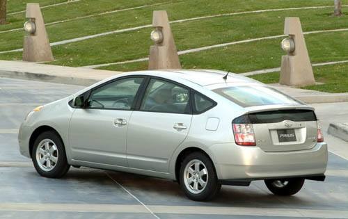

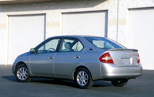

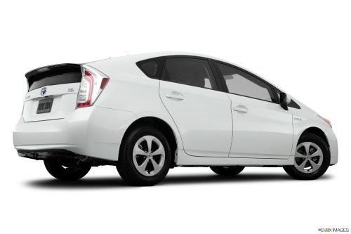

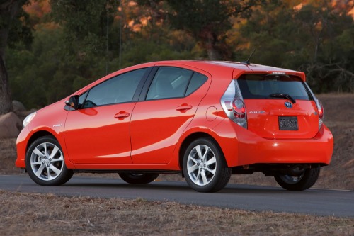

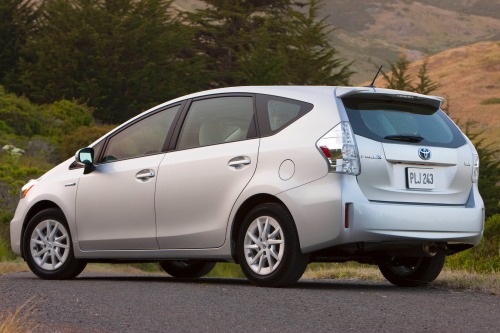

    Pictures of all Pri generations from Edmunds. Your 2007 should look like the Gen2 pictured below, unless you mistyped your model year.
