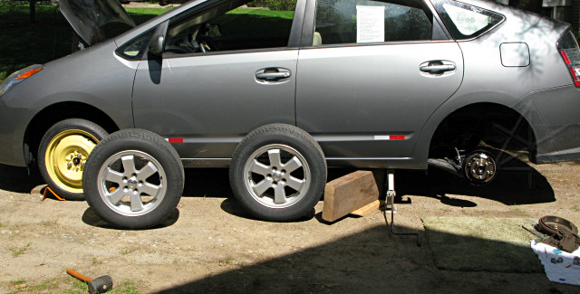

    A perfect Sunday afternoon is a perfect time to do a little
    car maintenance, so today I decided to combine a bunch of things
    including an oil change, what I hope will continue being a
    yearly cleanout/inspection of the brakes, and tire rotation.
    The scene at one point looked like this:
    The front disks needed a little de-dusting and regreasing of
    the backing plates and pad end clips, and a quick spin and
    limbering-up of the slide pins as excruciatingly detailed here.
    The rears were pretty much pristine and needed only a superficial
    wipe. The donut is being used to allow both wheels on a side
    to be off at the same time, and if you haven't looked at your
    own spare tire, yes, it really is that hideous yellow. In fact
    if you haven't ever seen it now is a good time to unearth it,
    gaze upon its blatant ugliness, and make sure it's pumped up
    to 60 PSI which is what it wants before hiding its wretched
    countenance in the oubliette of the lower cargo well again.

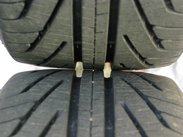

    Anyway, the Hydroedges are a directional tread and can thus
    only be rotated front-to-back, so having a side's worth of
    wheels off allows comparison between fore and aft treads. I
    had rotated them once about 5K after getting them, but now
    they'd been in the same positions for about 15K or more since
    wear had been completely imperceptible back then. Now, it's
    still more or less imperceptible by eye but perhaps discernible

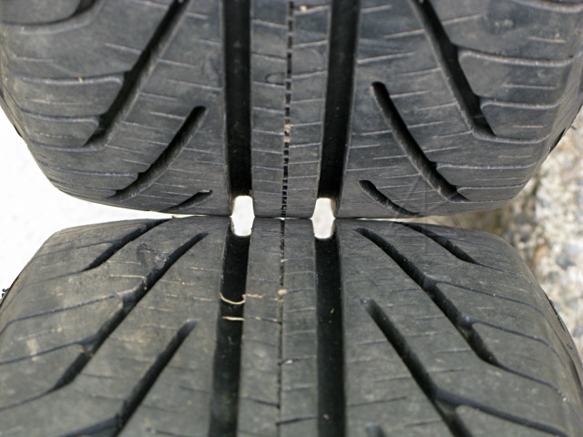

    by electronic measurement. Here are the left-side treads
    matched up together [front is above]:
    And the right-side ones:
    There isn't really any obvious delta -- maybe half a pixel's
    worth of tread depth in the pictures included here, if that.

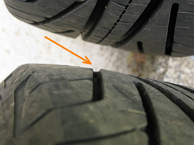

    However, something about the right rear *felt* funny as I ran my
    hand over the tread to brush off sand, and closer observation shows
    that it's got a little bit of sideways feathering in the tread, with
    one edge of the lugs feeling higher and sharper than the other:
    Hmmm. If the road had been scrubbing the tire very slightly
    to the left, that means the right rear spindle is toed in just
    a tiny tad. After 15K the tire is not particularly bad, but is
    definitely different from the front. Now, I had been starting
    to notice a very slight delta on the wheel speed display of
    late, concerning the rear tires, and observing that the LED blink
    rate on very gentle right or left turning was telling me that the
    right rear's radius had become very slightly smaller than it used
    to be. Mysterious, given that I re-checked and had identical
    pressure and temperature in both right and left. So now I guess
    I've got my answer, after many miles. Never noticed anything
    with the old Integrities.

    It that a 4 by 8 you're using for a Jack Stand??
    Come on, spend a few bucks to get some real ones!
    Guy used a cinder block once, the Caddy fell and crushed him dead!
    Guy used nothing but a three ton bottle jack to lift the front end of his car, car fell and cost him both of his legs.
    Kids were playing around a car up on four jacks stands, no tires on it, car twisted and fell off the jack stands, killing to of the kids hiding under neath it.

    Ditto SparrowHawk60! Using a 2x8 *on edge* (!) as a backup for the jackstand is foolishly dangerous. If the stand fails it's much too likely that the 2x8 will simply fall over. Yes, I see the wheel chocks: do you want to bet life and limb that the tires have so little compliance that the chocks won't allow the car to move a half-inch? Please use something appropriate to the purpose, we want to keep your expertise available.
    To create an annoying wooba-wooba sound? No, thanks :_>

    The wood wasn't actually needed or under any significant pressure;
    a halfass backup for vertical lift, NOT any pretense of lateral
    stability. Lateral stability was handled by the park lock and
    the chocks and the fact that the other side of the car was still
    on the ground, so spare me the "up on blocks" hysteria. And at no
    point during this operation, which I realize I will never convince
    some people of general non-sketchiness, was I actually underneath
    parts of the car. I was also careful to shake the car around on the
    way up to make sure it wasn't going to settle into some undesireable
    position. No more risk than doing a tire change at roadside with
    the stock jack, and that's the best I can say about it.
