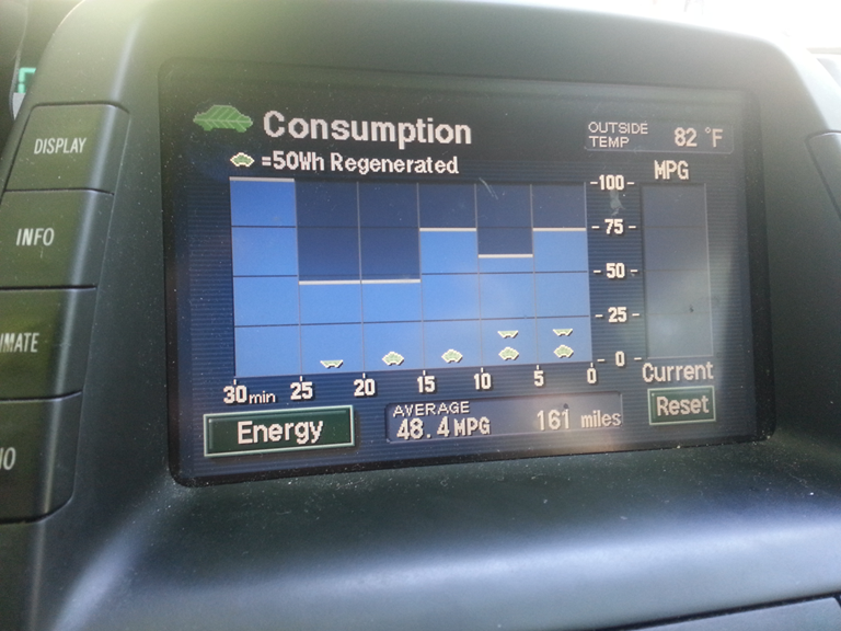

    So midway through this tank I started working on P&G, having installed a tachometer recently. The tank average has been coming up, and I achieved this (see attached) yesterday. I'm really looking forward to the next tank, where I'll start from 0 with the P&G.
    I'm really surprising myself with it. I used to try to baby the throttle and continuously use the engine at the highest MPG number possible. Now I've been sticking in the 1.5k-2k range as much as possible for engine on, with engine-off glides as much as possible. I think I'm struggling though, for times when it's problematic. Sometimes either the terrain doesn't agree with P&G or my rhythm is off, and also occasionally the engine is stubborn about turning off, even when I've previously glided during the trip and the SOC is good. I've also been completely avoiding exceeding 2k RPM if I'm not on the highway, and limiting to 4k for even the quickest acceleration (like certain short highway on-ramps where entering too slow would be dangerous).
    Further advice or feedback?

    Update: At 219 miles after errands today, I brought the tank average up to 50.5 mpg, indicating a 56mpg run on the 58 miles I drove today.

    If you are getting that kind of mileage, you are well into the zone of diminishing returns. Well done there. However, you don't want to take away attention from defensive driving to get what might amount to a few pennies. While I admit that playing the Prius video game is fun, so is just relaxing and enjoying the scenery.
