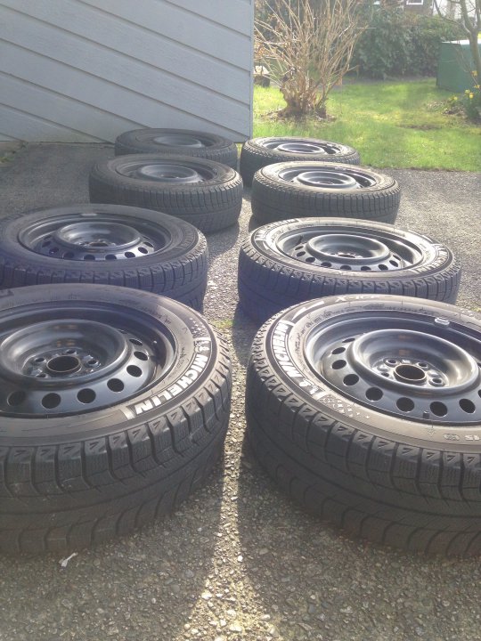

    Here's our driveway yesterday. Took our snows off the previous day, and our son's that morning. Getting ready to wash them. Notice daffodils in background? ;)
    Winter was a real non-event this year on west coast. Maybe becoming the norm? Snow tires were overkill.
