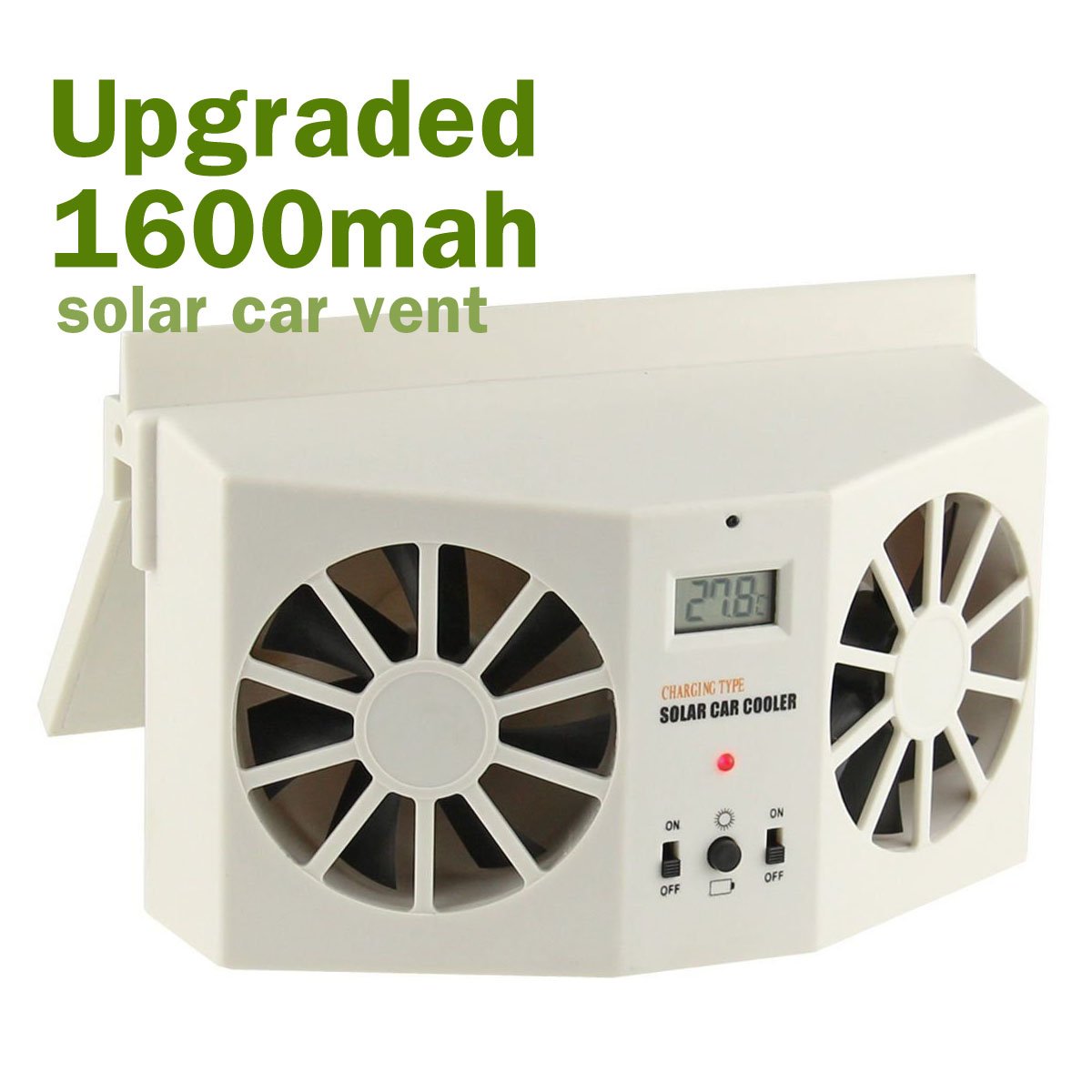

    Or it could be your window(s) are (is) partially open. I get the yellow triangle, exclamation point icon show up because I have this in my window
