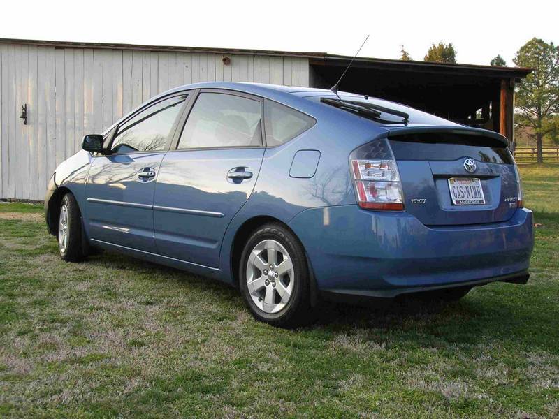

    For the full treatment I start with a thorough Dawn wash, then Z18 (clay-bar), one or two coats of Z5 for swirls and minor scratches as needed, and one or two coats of Z2. If needed, I do a quick detail with Z6 between coats, like last week when I did mine during pollen season. I top it all off with Z8.
    If I'm in a hurry or feeling lazy, I'll use Z-AIO followed by Z-CS.
    Here's a pic:

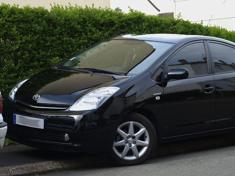

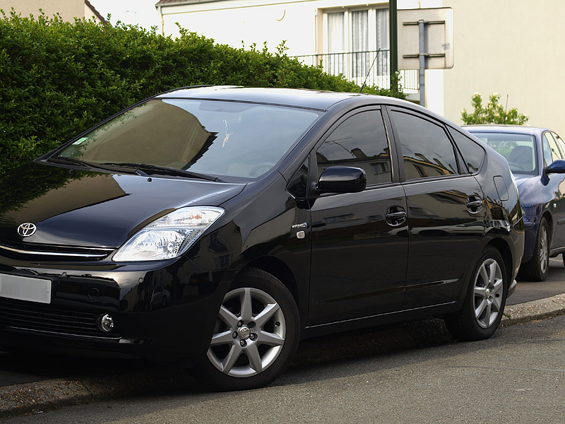

    Z7 (wash) Z18 (clay with dilluted Z7 to lubricate) Z7 again to remove Z18 residues then ZAIO or ZPC+ZAIO to prepare paint, then Z5+ZFX then Z2+ZFX
    The photo was taken a month after, after a quick HP wash and Z6 + Z8 application.

    No I'm not, there is an anti theft nut... that's all
