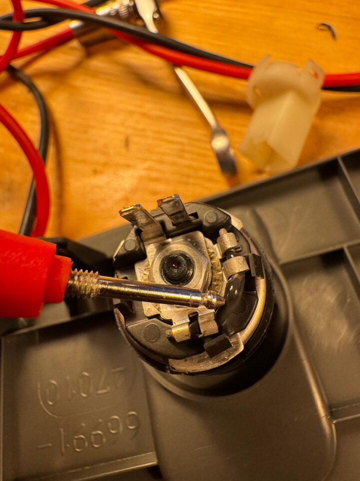

If power outlet fuse is not blown you have to look at the second fuse inside the outlet. Its a small black wire ( fuse ) that needs to be resoldered to fix the problem. see picture
