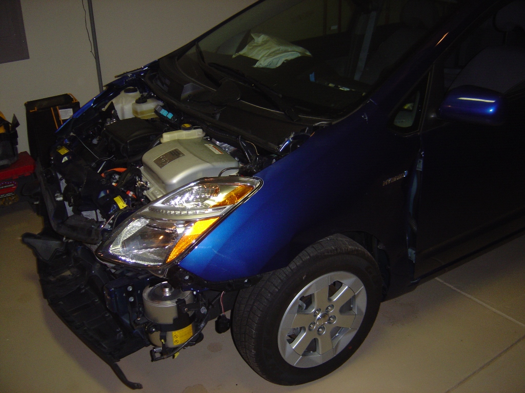

It just arrived last night on a flat bed and I drove it into the garage. It's a 2008 Package 2 with 5500 miles that seem to have met an early demise via a trailer hitch. No damage past the firewall and it runs and drives.

Is that the coolant canister, front left in the top pic? I wonder why they'd put it there. Doesn't look like there is very much to protect it from getting damaged in a front-end collision. Although, I guess it did survive this crash ...

Bumper, hood, headlights, fenders (I might be able to save the passenger one), radiator, fans, condenser, air cleaner, airbags, seat belts, and the top dash pad. It should run 3 to 4 grand when it's all said and done. I'm going to try and take tons of pics during the process.
Yep, that's it. The majority of the damage is on the passenger side to middle of the car. I would much rather replace a $35 intake resonator than the $600 coolant canister.
