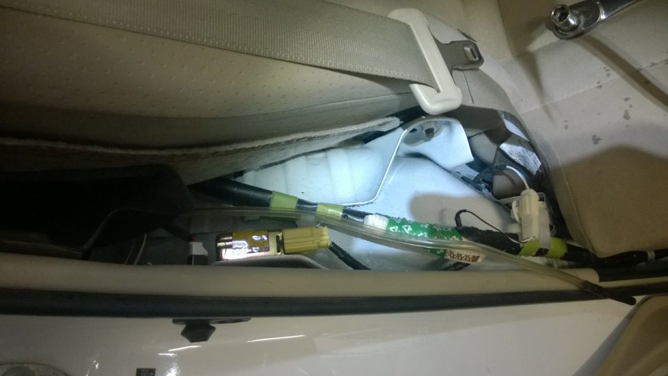

    I was sucking out the water when I realized the space under the carpet was like a water bed so I popped the panels off and pulled up a piece of carpet and found 1.5 inches of water. Stupid me for trying to find the leak.
    Stupidity aside, I found a spot where I think the leak originated from and it seems to be from a loose junction between two water lines (see the black part of the water line at the bottom right corner of the photo). There was water visible on the cables in the photo, starting on the black cable below the yellow plug. Whatever the thick black cable is was also wet (since it's thick and black, I'm guessing it's a bad one to be wet especially headed towards the batter).
    So it may be a simple repair but it will take some time to dry out while I pray nothing is damaged. WP_20141103_003.jpg
  7. bisco
    109,534
    49,797
    i can't believe they put a coupling there.
  8. smithBYU85
    smithBYU85 Junior Member
    Aug 7, 2007
    47
    Des Moines, IA
    I can't either. I pushed the hose in tighter and got water on the hatch window. I take some comfort knowing I didn't cause this, but I feel stupid for using as much water as I did looking for a leak. I sucked up as much water as I can and have drained the floor board (Toyota did put in some drain plugs in just the right spots). I'll let it dry for a few days while I go buy a new coupling.
    Well now we know that the fluid line runs down the passenger side before going up to the hatch.

  12. valde3
    valde3 Senior Member
    Jun 28, 2014
    2,002
    745
    Finland
    This seems to be pretty common problem with 10 or more year old cars. Maybe ice on top of the nozzle or if fluid has freeze at some point will aggravate this. I have only seen visual problems caused by this newer any electrical. Electrical connectors that have been underwater I have cleaned with ethanol and/or propanol. Disconnect 12V before cleaning connections if you don’t know what they are.
    If you’re worried that it may come apart or leak depending on connector you can use heat shrink tubing (best or sometimes necessary that it has glue) and/or zip ties.
