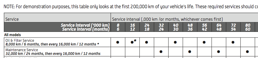

    I do not know, looking at the table in the linked PDF I think it's 16000 km after 24000 km.

    Let me try this another way...
    Page 25 calls for the following at these intervals:
    8K - Oil & Filter Service
    16K - Oil & Filter Service
    24K - Oil & Filter Service
    32K - Maintenance Service (which includes an oil change)
    40K - Oil & Filter Service
    48K - Maintenance Service (which includes an oil change)
    etc.
    (they alternate names but both include an oil change)

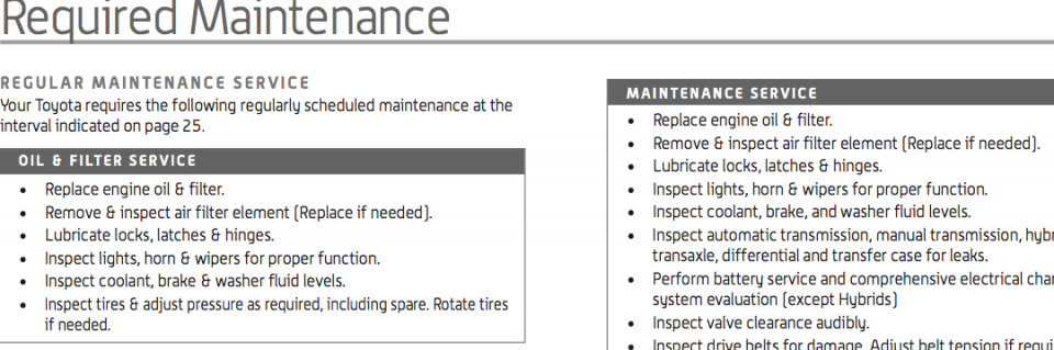

    Page 26 describes the "Oil & Filter Service" and "Maintenance Service":

    I see your point now.
    Still not sure though. I do know it's subtle enough that it's going to stump even a seasoned service writer. The Canadian schedule continues in it's usual all encompassing, confusing as hell style.
    Moot point for me, I'll stick with 8000 km or 6 months, per the 2010 book, gives me a fall and spring chore.
