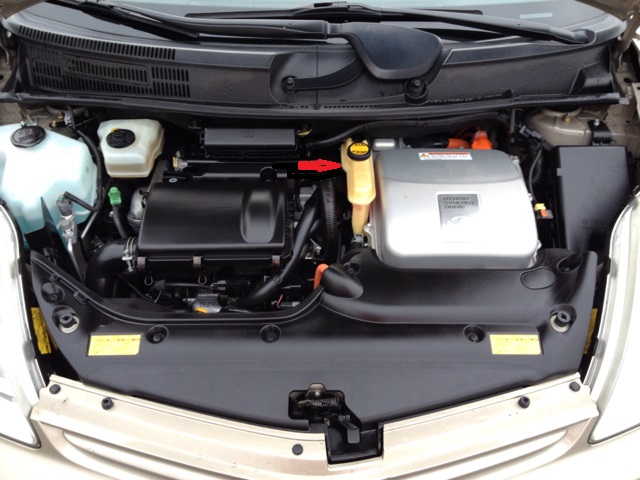

    Honestly, this may be your inverter coolant pump gone bad. Can you turn your car on and check for turbulence in the inverter coolant reservoir and report the results back here?

    I don't mind getting my hands dirty. I generally know how a vehicle works, turn some nuts and bolts, etc. But finding the inverter coolant reservoir would be a new one for me. At the same time, I have no issue finding a diagram or youtube video. ;) I'll take a look.

    Here is an image of my 05's engine compartment, the red arrow indicates the inverter coolant reservoir. Open the cap while the car is on and look for turbulence (water moving around). The symptoms you describe are classic for an inverter coolant pump problem.

    I seriously can't thank you guys enough with the information provided. I'm a member who will enjoy reading this forum even if my car is new now. The overall information and help is absolutely great. Thanks for taking the time to photograph under the hood and show me where to look. Learning more about these vehicles is great.
