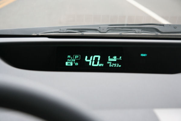

    Does the Prius become READY or not?
    I am not sure what "lights just flash around the gear display" means. Can you take a sharp photo of this and post?

    When in "Ready Mode" you will see the word "Ready" on the dash and the Prius is in normal operating mode. Also in ready mode the led on the power button will be dark (no color).
