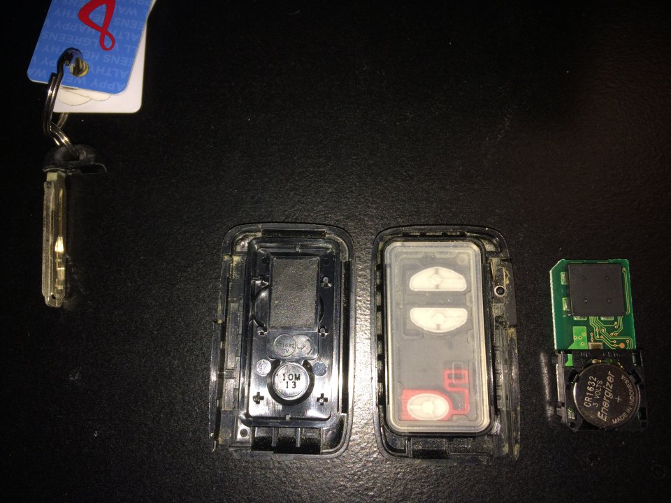

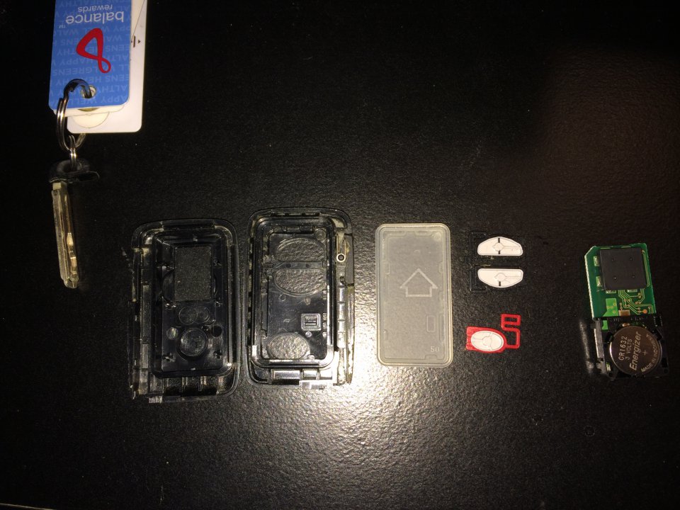

    My key fob looked like it had spent a night in a mud puddle.
    I disassembled it and used cotton swabs and alcohol to clean it up a bit.
    It dried out quickly before reassembly.
    I had better luck inserting the circuit board in the light color rubber then inserting them into the plastic case.
