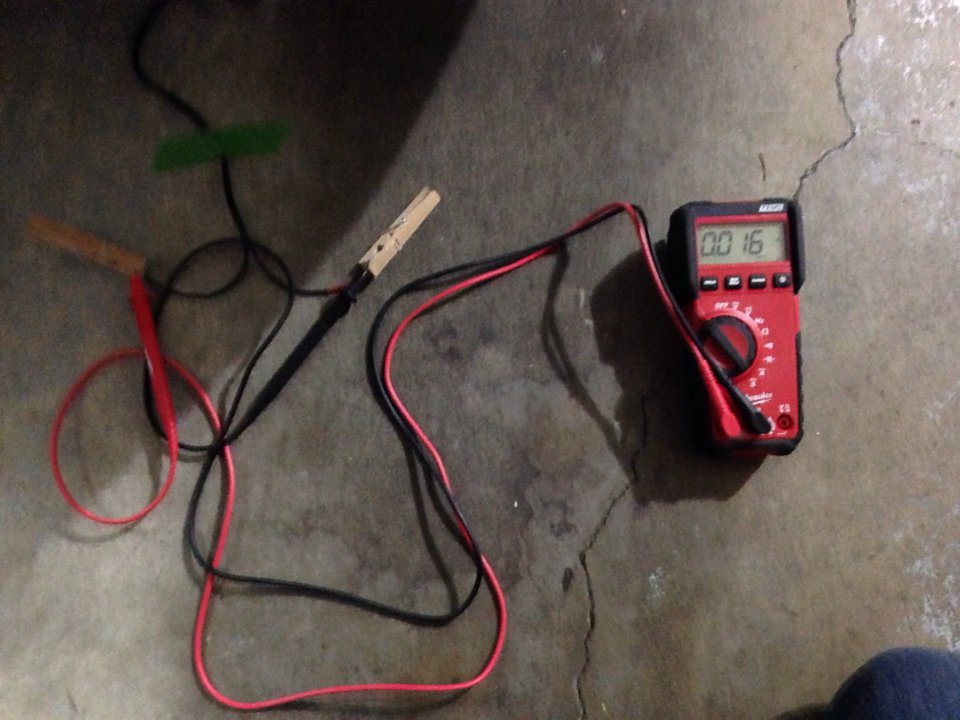

    Following the first method in the second video I posted above, I checked for phantom power usage this morning. Looks to be very low, around 16 milliamperes, with little spikes to around 40. Maybe due to the flashing security light? Acceptable is said to be on 20-50 range, so good I guess. :)
    (Finally sorted out posting images on an iPhone, need to click on text ABOVE button, button inactive. )
    Gotta get some alligator clips for my new meter, lol.

    These are the steps I followed:
    1. Hooked up a charger at the underhood jump start point. (CTEK 3300)
    2. Disconnected negative battery cable. (looped the cable end through cargo hold down net D-ring, for safekeeping)
    3. Hooked up alligator clips with longish leads, one to negative post, and one to end of negative cable.
    4. Ensuring leads stayed separated, ran them out through hatch and taped to floor. Then closed the hatch. (Leads are barely pinched, no trauma.)
    5. Set my multimeter to amperage, moved red lead over to amp plug in, hooked up multimeter leads to those run out of hatch. (Mine is multiranging, if not, you want to set to highest scale at first, for safety.)
    6. Disconnect the charger. Don't open any doors, keep your fob out of vicinity, wait a while and watch multimeter readings. Mine were initially high, over 1 amp, especially before disconnecting the charger. Then the settled down a bit, then went way down. Seems to take a while for everything to shut down, go to sleep.
    7. Reconnect charger.
    8. Disconnect multimeter.
    9. Disconnect alligator clamp leads from battery and negative cable, and reconnect battery.
    10. Disconnected charger.
    FWIW, with a battery that's a bit over 4 years since install, charged a week or two back: after a drive to burn off surface charge, the battery showed voltage (at rest, on multimeter) of about 12.7. Then a few days later 12.6. This morning it's around 12.39. Doesn't appear to be parasitic drain, I'm thinking it's just deteriorating, not able to hold a higher charge. It does see to stabilize around 12.35~12.40. May be a new battery in the cards for me soon, too.
    And yeah, even if you install it at point of sale, it's good to hook it up, say as soon as you get home, let it fully charge with a smart charger.
