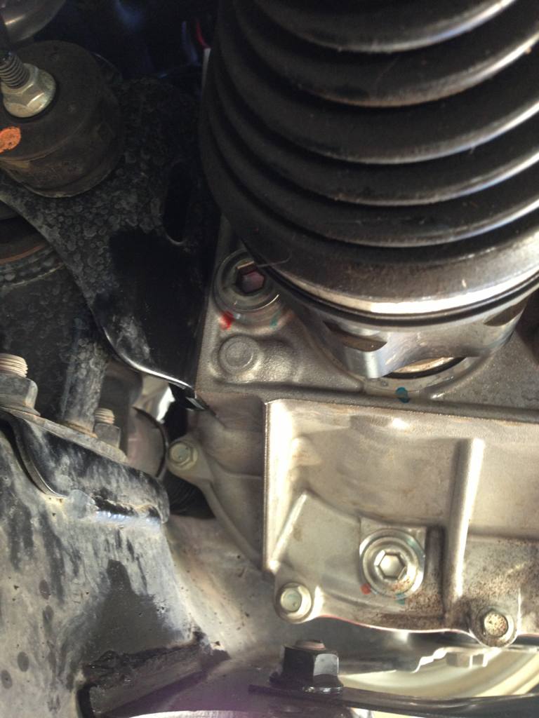

    Hey! I'm trying to change my trans fluid on my 2010 Toyota Prius I, but I go under there and look, and there's NO drain plug and NO filler plug! It's just completely solid, with a black electrical thing on the front (looks like an electric pump or sensor of some kind). I've watched videos, read articles, read manuals, and you guys are my last hope! I would just hate to have to take it in to the same dealer who's telling me "it's good way past 100k miles... blah blah blah..." .

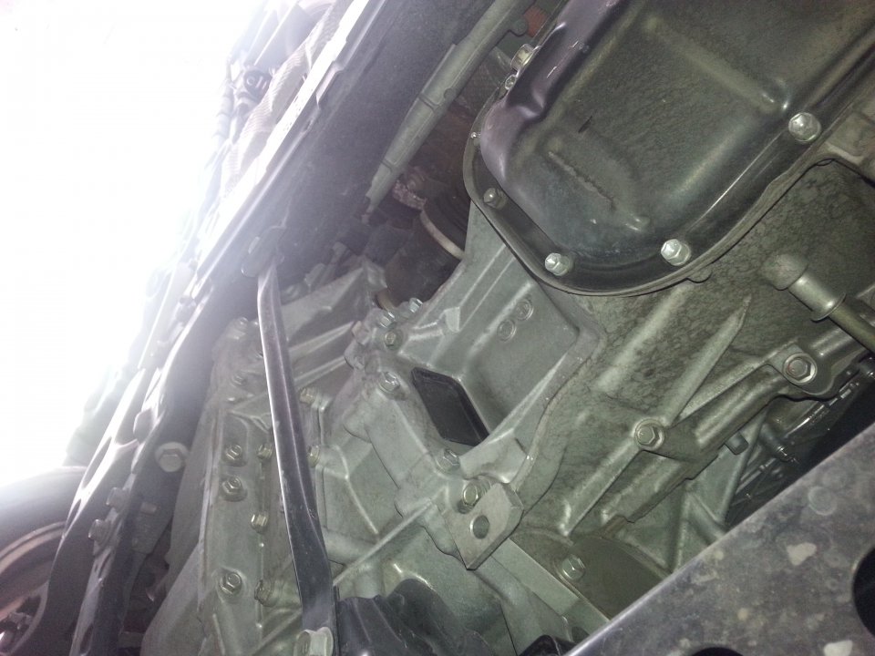

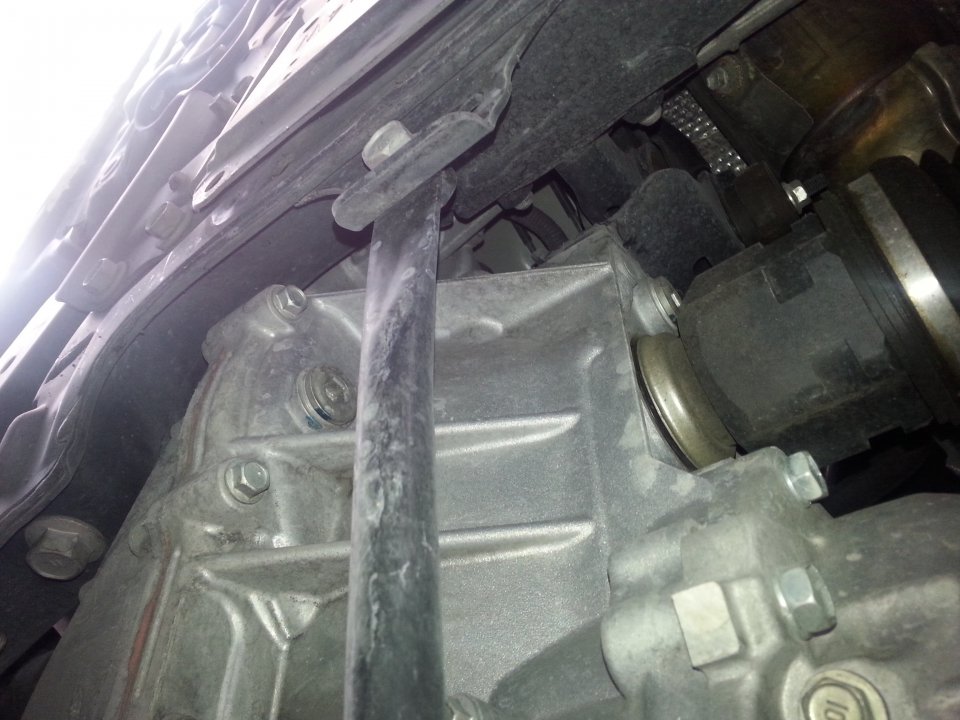

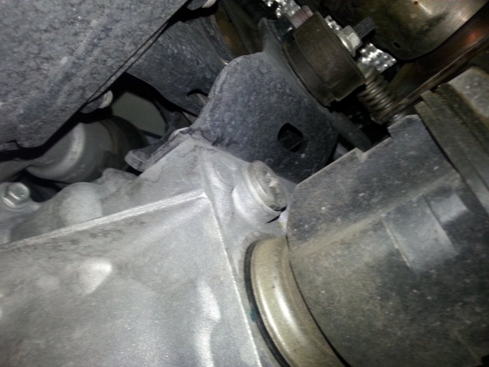

    So these are the only two plugs I found, both facing the rear of the vehicle, on the drivers side, by what appears to be some kind of driveshaft and stablizer bar...
    Are these the drain and fill plugs?
    Thanks.

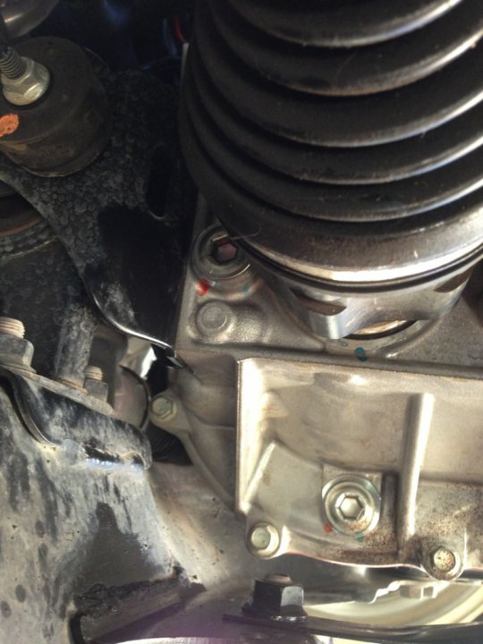

    So from what you're saying, I think, the thing I'm pointing at with this red arrow should have a black boot on it, with a large metal shaft sticking out from that? Some kind of driveline/driveshaft?

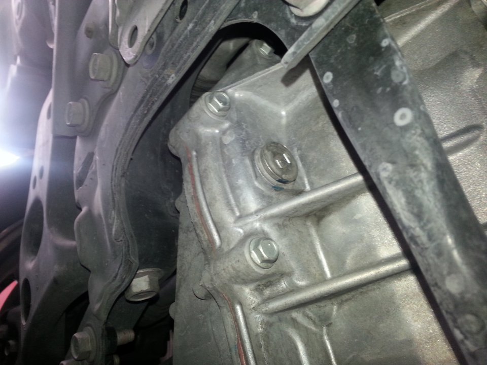

    This is looking from the passenger side towards the drivers side. The drain plug is at the 6 o'clock position, the fill plug is at the 9 o'clock position just to the left of the cross shaft. Both the fill and drain plugs are the 10mm Allen head bolts. I just did mine yesterday, as recommended by others in the threads linked above before you drain it make sure you can get the fill plug out.

    Just make sure you at least crack it loose before removing it... I heard these CVTs build up pressure, and if you don't take the fill plug out first, you won't be able to get it out. That darn bar was in the way! Lol.
    Another note: In my opinion, I'm glad it drains to the side facing the passenger, only because the side to side leveling is easier than front to back. In my opinion! :)
