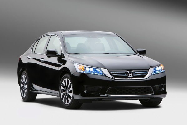

    Intersting little oval port in lower grill. Some type of launcher? :)

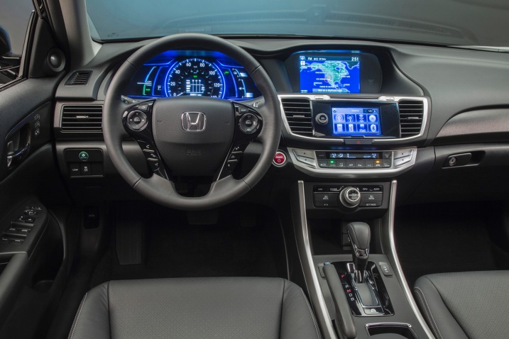

    I could live with this interior in tan or light gray
    Whatchya think?

    Oh wow. That's actually kind of nice.

    Can't believe they copied the awful 4 spoke steering wheel design of the Prius.
