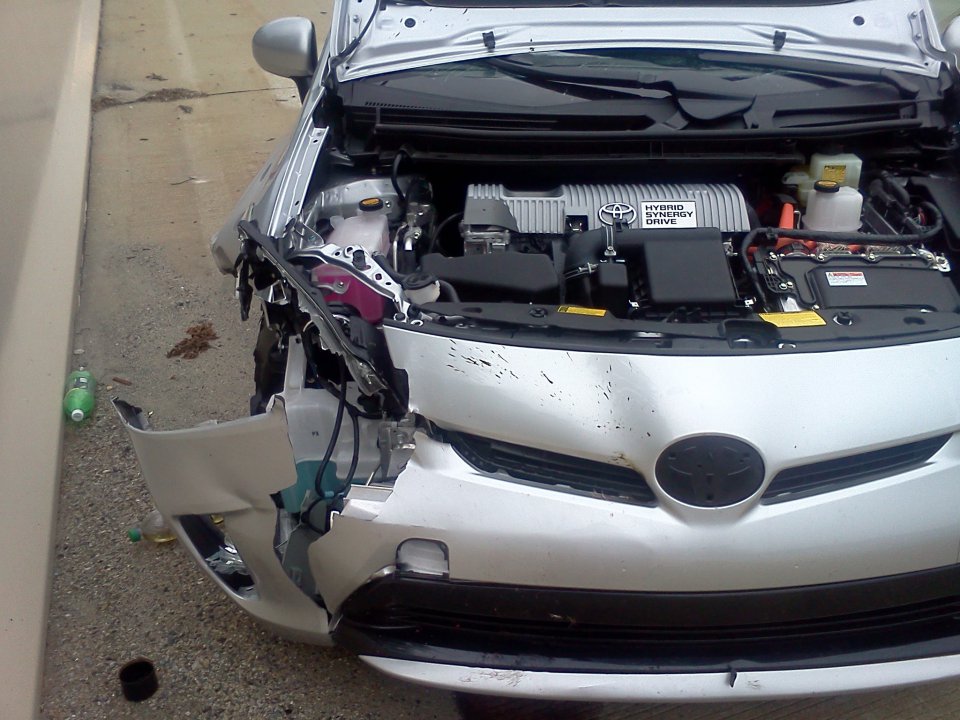

    I was driving on the highway, beside the concrete wall that divides the two directions. Suddenly, I saw a deer in the air, jumping from the other side of the wall. It landed on my windshield before I realized what was happening. The windshield smashed and the hood opened. I couldn't see a thing. I tried to hold the wheel and stop the car. Then I guess I hit the the concrete side wall and stopped. All the air bag discharged. I walked out unharmed, except a little bit disorientated.
    The Prius was actually beeping. Then I powered off it. I smelled a strong smell of burning plastic. I looked the front, the coolant for ICE was ok. but the coolant for the hybrid system was gone. The window wash tank was fine but the right head light was gone.
    Now my Prius is at dealership's bodyshop. the Adjuster has inspected the car. The preliminary estimation is over 13k. I guess they will fix it because I just bought it for one month.
    I think I was very lucky because it was rush hour on the highway and I didn't get hit by other cars. Now I am concerned about my Prius, will it be completely restored? This is my first accident and I would like to hear any experience on restored Prius after accident. Do they have any guarantee on the restored Prius?

    If all of the airbags deployed, I'm surprised they didn't total it.

    I don't know if they will fix it or not. They sent me a long list of parts will be changed. they will use 3rd party parts for A/M Inverter cooler, windshield, AC condenser, A/M condenser.

    major bummer! glad you're okay. i don't think the car will ever be the same. maybe it depends on the bodyshop. this happened to my daughter and the car seemed fine, but as the years went by, odd things happened that just didn't seem right. all the best, i hope they total it for you.(y)

    If it amount to sheet metal and component damage I think you will be ok. If they have to put it on a frame jig and pull/straighten any of the structural members, I wouldn't accept anything less than a new car.

    Don't accept the insurance company's first offer. Ask for all-OEM parts or a new vehicle.

    A friend of mine once worked for AAA. He said that once the frame is bent, it's basically totaled. But otherwise, they can fix it.

    Yeah. The cars now days have crumple zones that are part of the complete safety engineering. Insurance companies are reluctant, if not adamant about not authorizing any of those kind of repairs. That's one of the reasons our insurance rates are so high.

    Don't be surprise if you start to notice weird things with your Prius be it mechanical (such as engine, suspension, electrical) or if its cosmetic (paint, panel misalignment, loose screws, non-mechanical rattling or sounds). You can't realistically compare 1-3 body shop workers dismantling/reassembling using 3rd party parts vs. Toyota factory w/ trained assembly line and precisely calibrated machines using carefully engineered/produced parts.
    Not to scare you, there's body shop work that comes out great. But just be aware that any small clip or screw that's not put on or torqued correctly can lead to annoyances such as rattling, panels coming loose, or maybe something more major in the long run.

    make sure you get a OE - Toyota DENSO condenser. I mostly fined after a body shop repairs a Prius and recharges the air conditioning the a/c compressors dies after 9 to 18 months later. This is were I see most of my Prius a/c work comes from other shops that recharged it before. It usually always works when it leave the shop but dies later.
