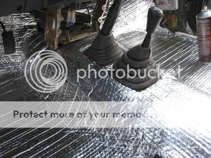

  7. E Risch
    E Risch Junior Member
    Aug 20, 2015
    49
    Nashville
    Reflectix foil insulation (home depot $15) works well, I overkill it with bedliner. better sound, better a/c & heat[​IMG]
