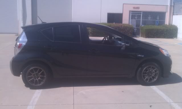

    Post pictures of the wheels you installed with as much data as possible.
    Wheel Brand
    Wheel Model
    Wheel Weight (preferably from a scale, but manufacturer weight is ok)
    Size
    Offset
    Tire Size
    Tire Pressure Monitors
    Difference felt in ride quality (if any)
    Price Paid
    Fitment Issues
    Hope this helps future buyers :)
    Wheel Brand Drag
    Wheel Model DR31
    Wheel Weight 14 lbs
    Size15x6.5
    Offset 40MM
    Tire Size STOCK
    Tire Pressure Monitors YES, NO ISSUES
    Difference felt in ride quality Exactly the same as stock
    Price Paid 360 for the wheels/518 including tire swap and light weight lugs
    Fitment Issues NONE

    I
    Tires installed: Stock?? or xxx-xx-xx??
    Tire pressure monitors installed? y/n :cool:

    Is that color gunmetal?

    ^They're bronze.
    Very nice wheels. It needs a drop though. And what's with the 80s-style glam soft-focus picture? :p

    OH MY GOD. I think I know that background. Was this taken near a kareoke shop in LA???

    Thanks Angel,
    Original post has been updated with that info.
    Mac,
    The picture was taken with my broken down phone unfortunately. I will try and add some nicer ones soon.
    The wheels were installed in South El Monte in a commercial area close to the corner of Santa Anita and Rush I believe it was. Didnt see any Kareoke around there.

    Nice!!!:rockon:
    I think I'll buy this ones for my PC-1

    i like those. available in black? price etc?
