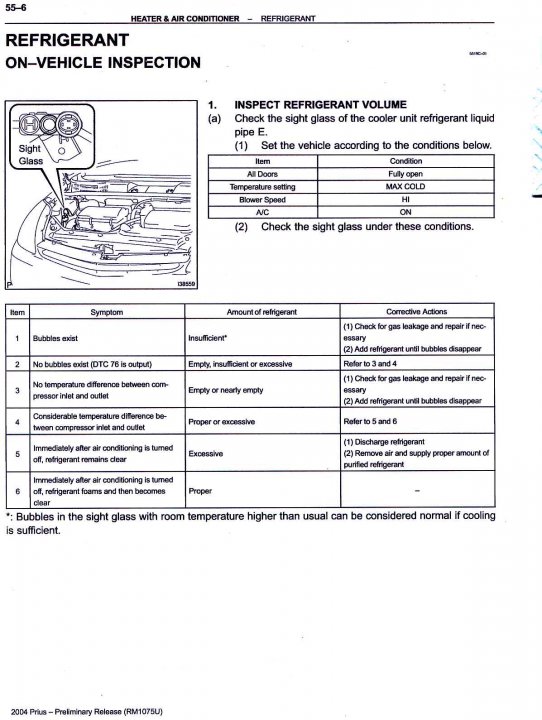

    If the AC is working ok then leave well alone.
    The only serviceable items if it working are the cabin air filter and removing the bacteria that cause the smell, and checking the drain hose is clear. To check the drain just run the aircon for a while if water can be seen dripping from under the car it is clear.
    The level of refrigerant can be checked by following the instructions below if this is your concern.

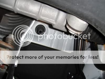

    Surprised Ed hasn't jumped on this. He is a strong advocate for the drain cleaning option. Basically some kind of foaming cleaner is injected through the drain tube up into the condenser to clean the mold inside.
    Here is a picture of the drain tube:
    Also it's good practice near the end of trip to turn off the A/C but leave the fan on and open the vent to outside air to dry out the condensation to prevent mold from growing.

    Which area under the car is that found?
  15. Britprius
    Britprius Senior Member
    Jun 14, 2010
    5,194
    1,912
    Herefordshire England
    Underside of the car to the rear of the engine and transmission towards passengers side. An exhaust clamp with spring can be seen on the left of the picture.

    Dealer in my area charges $100 out the door. $150 in Cali sounds right. If you can't do it yourself have them do it.
    You have to jack the car up pretty high to get under that area. Its easy once you jack the car up but I hate that part.
    That hose is right behind the pass wheel 2 feet in. You have to be right under it to see it.
    There's alot of mold building up in that case and its a very good maintenance thing. If the mold corrodes it can really clog up the ecoil and kill ac efficiency. If really bad the evap coil itself needs to be replaced. Thats really really $$$$$$.
    There is a TSB out for a new evap coil. I prefer to just maintain mine because if they rip the dash apart I know it will never ever be the same. I have no squeaks or rattles now.
