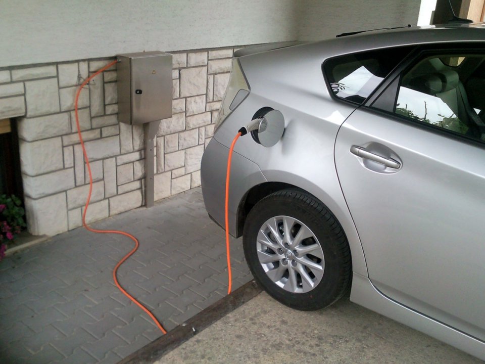

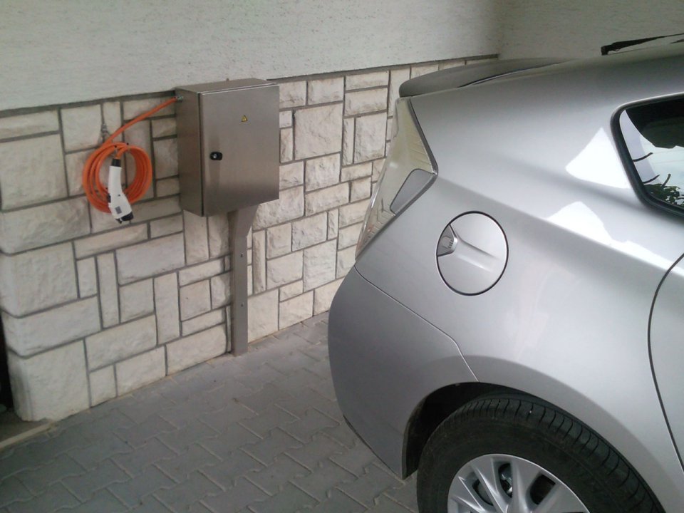

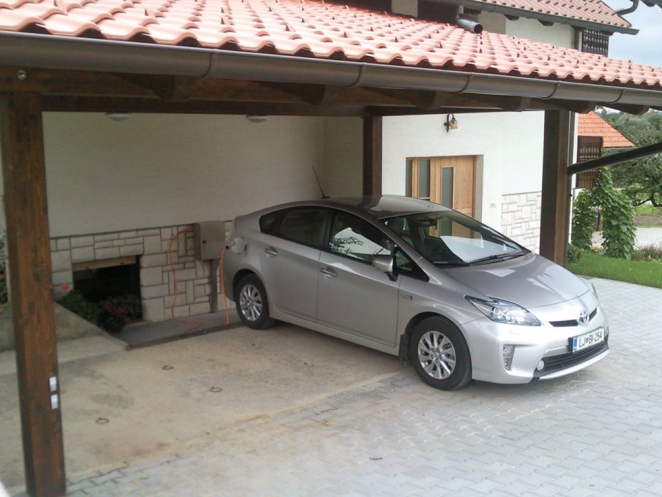

    I bought this: EV-Power | Assembly kit: Charging plug J1772 with cable (16 Amp, 5m) incl. electronics and I am happy with it. It cost me 220EUR + VAT. And another 20EUR for certified electrician to wire it up for me. I can't tell how much waterproof it is, since I have it hardwired to a wall cabinet and located under a roof. Together with my PiP safely away from sun, rain, snow... :love:
    I shall make a photo of final result and post it here for you.

    Here are the photos of EVSE connected to the wall cabinet ...
    "The big" picture:
    The wound-up EVSE:
    Charging:
