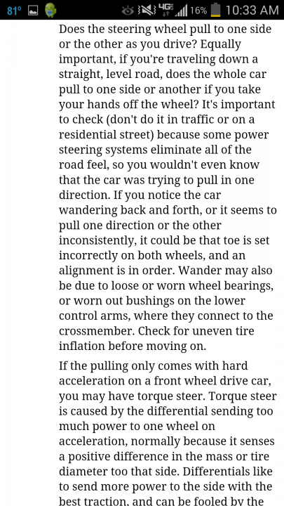

    My tires still look great... had Toyota replace my driver side axle a month or so ago because of a dumb mistake of mine. Not sure if they needed to do another alignment after but everything I'm reading says they don't have to. Now all of a sudden this week I have this going.... describes it to a T
    and first paragraph on second pic...
    anyone else experience this mess??? Was doing fine after about 1000 miles on the tanabe df210 then an alignment from Toyota now this. Wife hates everything I'm doing to the car and of course she's like Toyota.. it's my fault cause I lowered it haha

    Well.....driver side lower control arm bolt was loose. Weird because instructions for install of front sway call for to loosen them but we torqued everything back to spec. Not sure if Toyota messed with that during axle replacement but my friend at the alignment specialist shop says if he had installed axle he wouldn't have touched it so they shouldn't have but who knows. Fixed now and glad it wont nothing major!
