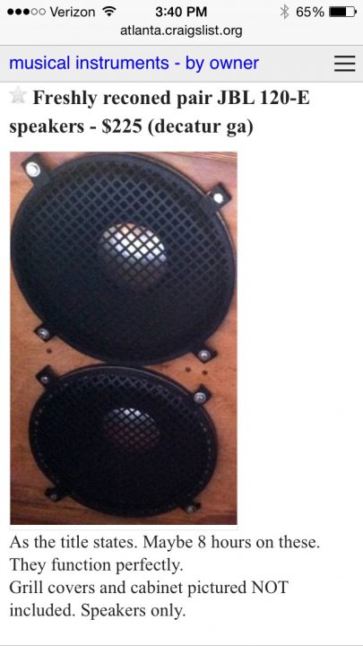

    Put 2 of these in the back and you won't need anything else! About 20lbs each (at least the AlNiCo magnets, e series are the round cheaper ceramics we're all used to seeing). These were the first to break 100db's. Ribbed cones, aluminum dome (really shoots out the highs), vented voice coil and cloth surrounds.
    Recones are always a crap shoot, though.

    Those are $225 for rebuilt speakers. We're talking about $90 speakers. Can those even operate as free air speakers?
  9. Stratman

    Yea no problem. If they were original cones they would be about 225.00 a piece. Work great in an open back guitar amp, closed back, or ported box. These are still considered THE primer Hi Fi and professional guitar amp speaker. If you wanted to send sub frequencies to it (them) a closed cabinet will yield better damping which let's you drive them with more power. At 101db it would be about twice as loud as a 92db speaker. It takes about 7 times the power to double volume or about 6-9db's.
