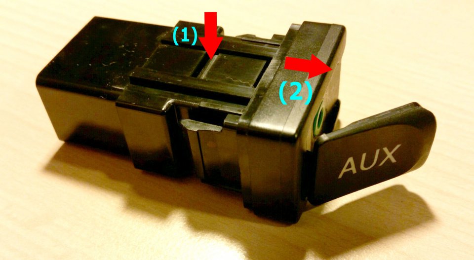

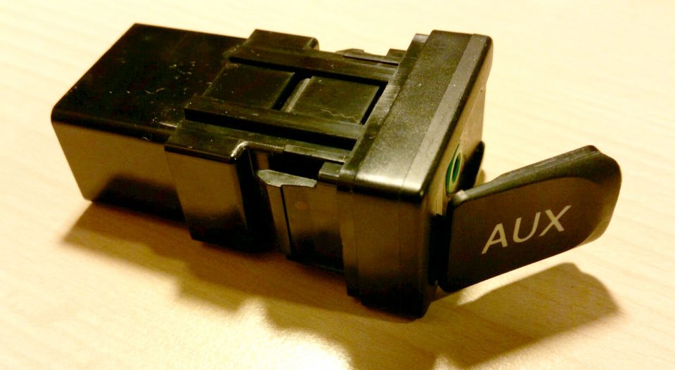

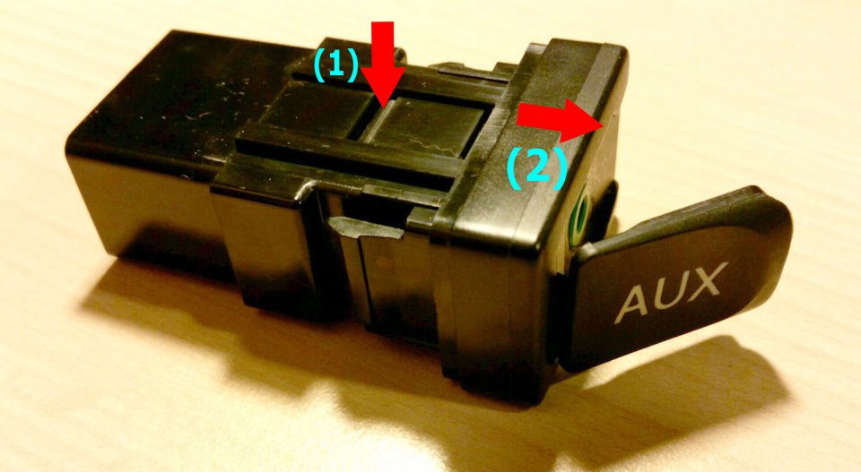

    First you need to take the unit apart

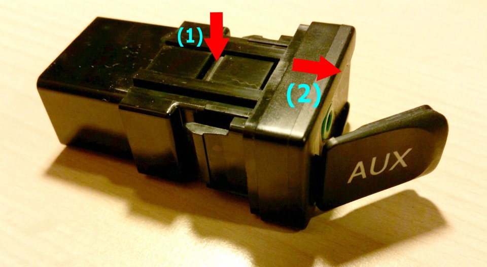

    Just push on the retaining tabs (1) on each side whilst pulling the end part (2) off, as shown.

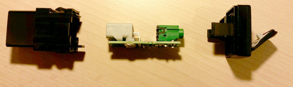

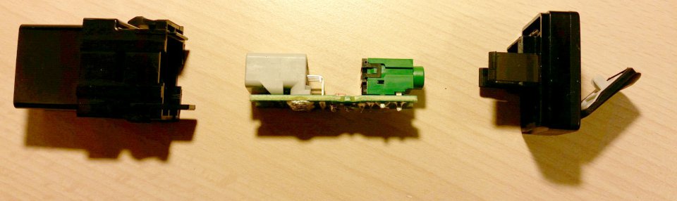

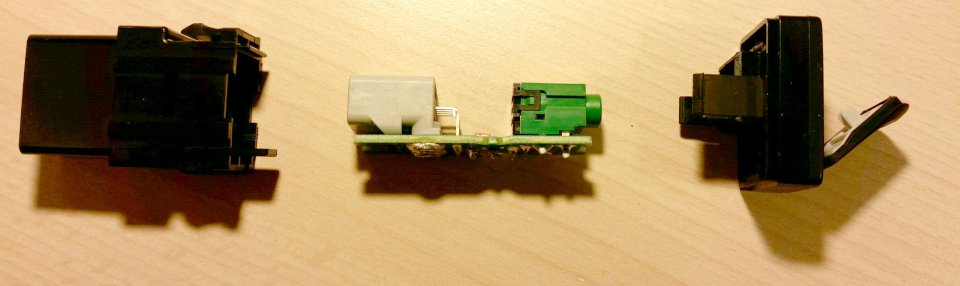

    You should then be able to extract the circuit board, and have three main parts

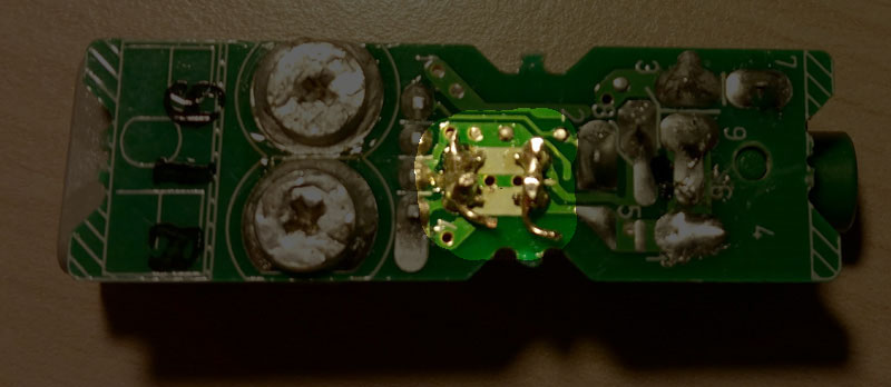

    The circuit board does some fancy switching when there’s a plug in the jack socket. The plug that connects this unit to the stereo head unit has 4 wires; the usual three for the stereo signal, plus one that’s used to signal that there’s a jack plugged in (I’ll call this the ‘jack-signal’ wire).

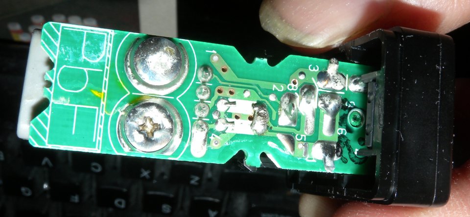

    When the jack socket goes bad, it fails to open the necessary contact, so the wire never receives the signal. In a working unit the resistance presented between the audio ground wire and the jack-signal wire changes:
    No jack in the socket: 14.8 kilohm
    With a jack in the socket: 2.6 kilohm
    I noticed that the two resistors on the board would have a combined resistance of 2.6 kilohm if they were in parallel.
    I figured that – without having to try to repair or replace the little jack socket – I could convince the head unit there was always a jack plug in the socket if I connected the two resistors in parallel permanently.

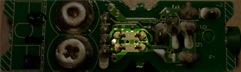

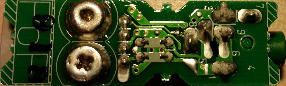

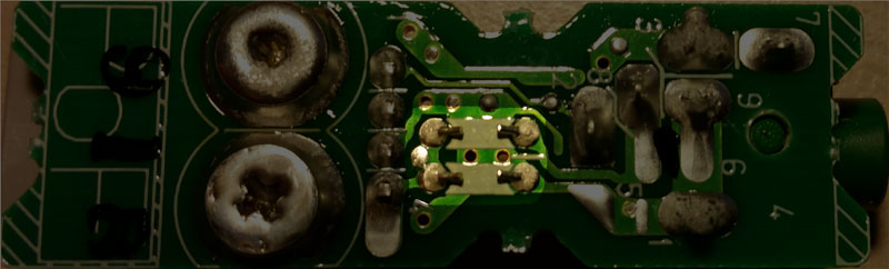

    Here's the circuit board as I found it, with the resistor connections highlighted:

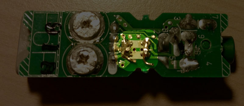

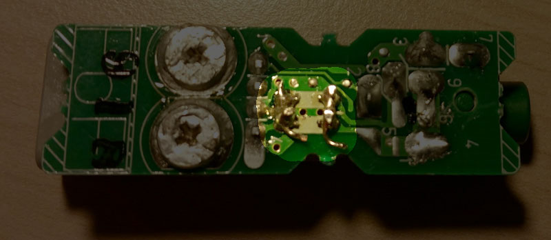

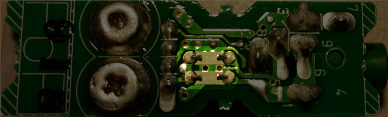

    Below you can see what I did. It could be neater – but who’s ever going to see it!?
    This now works. Your mileage may vary – so beware that this fix may not work for you. However, if the part number on your faulty unit is 86190-53010, it ought to work.
