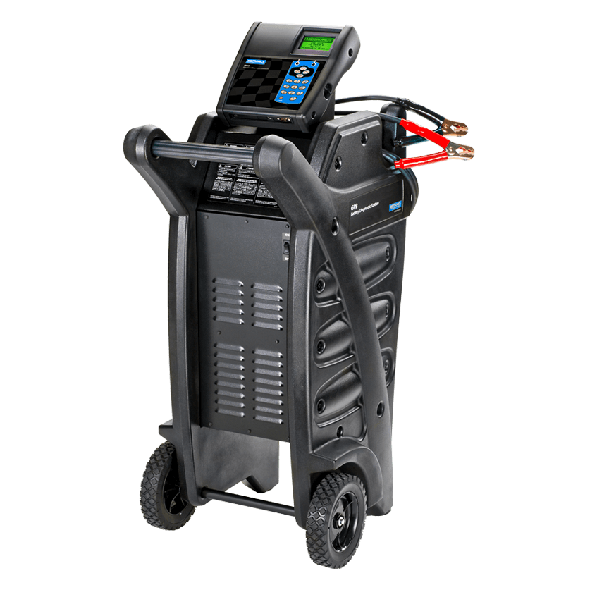

    Thanks, I will have to start looking at it now that car has come back from workshop after brake zjb fix, sitting at dealer for 3.5 weeks took a toll on battery, had to fork out 300$ for new one as this would enable dealer to brake bleed.
  20. ChapmanF
    ChapmanF Senior Member
    Mar 30, 2008
    23,406
    15,164
    Indiana, USA
    This is what's supposed to enable the dealer to brake bleed:
