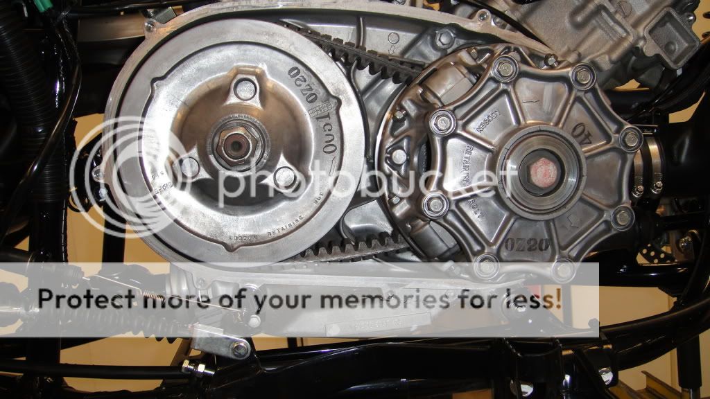

    If the smell was not from the tire spinning/burining, it could have been from the CVT system, like belt slipping between the coverter sheaves.
    Shown below is a typical CVT system but not from Prius obviously.

    The Prius does not have a belt or pulleys. The transmission of the Prius is not a mechanical CVT. The mechanical portion has fixed gearing; not shiftable, no clutch, no pulleys, no shift bands. Only the electrical power path is variable.
    Tom
