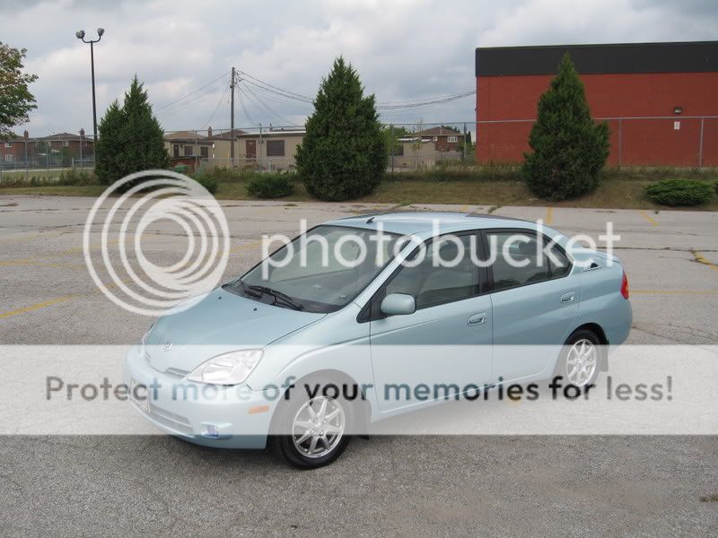

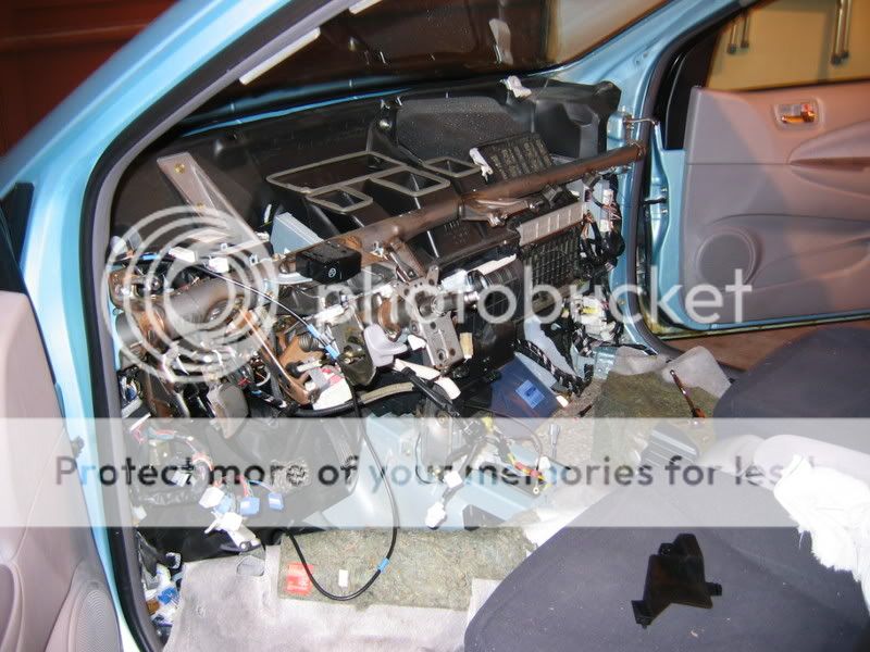

    OMG, that picture is amazing. Guess that just using an aftermarket GPS with suction cup mount would be too easy for you! ;)
    The other photo of your car's exterior is great. A beautiful car, I wish I still owned my silver 2001.
    Hmm, maybe there's a business in smuggling Prius traction batteries across the border into Canada. Anyway, glad that your car is running well again.
