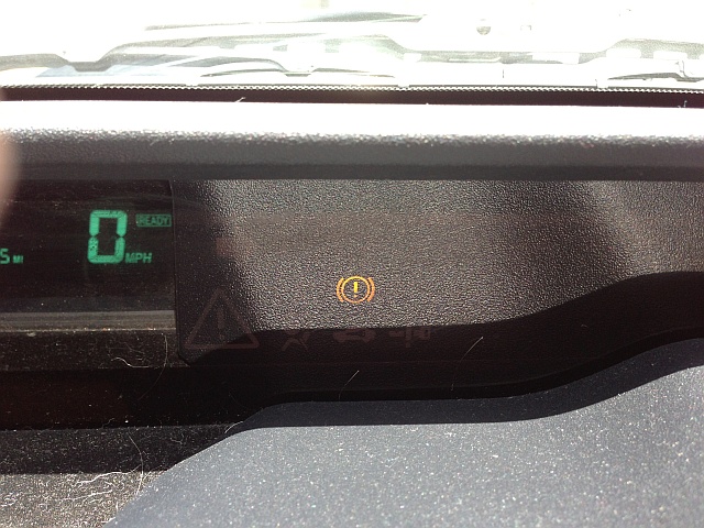

    Hey folks. I did a forum search but was unable to dig up anything with a combo problem like the one I am having.
    I have a 2004 Prius. The yellow brake warning indicator light is on. I also notice that there is a noise coming from under the hood near the dash whenever: a) I open the driver's side door; b) the car is on or running, including while driving; c) for about a minute or so after shutting the car off... unless I again open the driver's side door. The noise comes on and off, on and off, in any of these scenarios. On for about 3-5 seconds, off for about 3-5 seconds, and on again.
    I used to have another 2004 Prius before, and I remember this sound, but I only remember the sound from pressing the brake to start the car, and right after turning the car off, and only for a few seconds.
    So I am wondering if the two issues are related... perhaps a regenerative braking thing?
    I'd rather do some research before shelling out money to the dealer/mechanic. Any help is appreciated.
