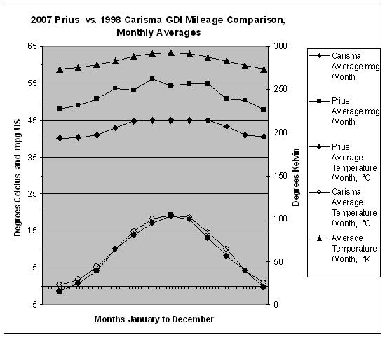

    Three mpg data outliers, which were known to be caused by unusually high speed trips, were excluded from the calculations.
    Average climate data from a nearby city is included for illustrative purposes only. Actual temperatures while driving were not recorded, and tend to be more extreme than the averages.
    The mileage data lags behind the temperature data, because fill-ups often include trips from the month before.
    The monthly mileage averages are not distance weighted, but are a simple average of the tank averages, and the seasonal averages are simple averages of the monthly averages. This gives equal weight to every month, regardless of how many miles were driven in each month.
    The calculations do not give exact absolute values for the exact time frames, but they are calculated in exactly the same manner for both cars, giving a fairly exact relative comparison on average.
    There are small variations due to the smaller sample size for the Prius combined with random weather and tank fullness variations, but on average, the mpg decrease of the Prius in winter is about the same as the Carisma. In time, with additional data, the Prius mileage curve is expected to smooth out.
    Plot of average monthly average mpg of eight years for the Carisma, and three years and three months for the Prius, in predominantly low speed highway driving.

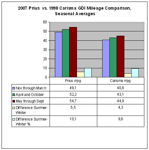

    Graph of average seasonal average mpg of eight years for the Carisma, and three years and three months for the Prius, in predominantly low speed highway driving.

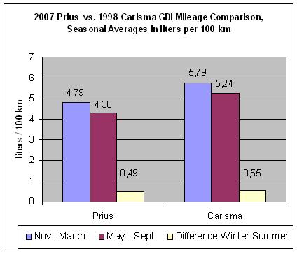

    Graph of average seasonal average of eight years for the Carisma, and three years and three months for the Prius, in predominantly low speed highway driving, in liters per hundred kilometers.
    Although the seasonal difference appears higher for the Prius when calculated as a ratio to the Prius's lower average consumption (mi./gal.), this graph shows that the absolute difference in the amount of fuel consumed in a given distance was actually lower for the Prius.

    Thanks for the effort. Looks like the two cars show the same change, within experimental error.

    Also, expressed in terms that better reflect the absolute amount of fuel consumed, the Prius actually has a slightly smaller difference in fuel consumption between winter and summer of .49 liters per hundred kilometers vs. .55 for the Carisma.
