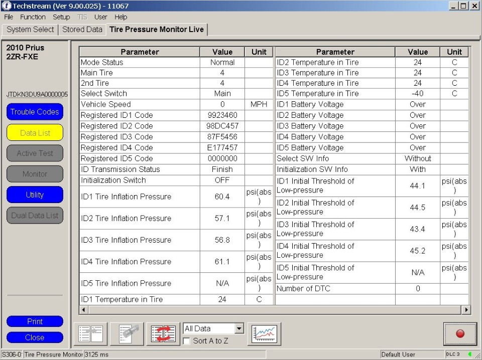

    what model of the display/audio/navi did i need to get that?
    I rented a POS low end chevy compact Years ago that i toggled thru each wheel all the way up to Sacramento, watching the tire pressure change with the heat of the day, and what side of the car was in the sun.
    I don't think my version has this however... :-(

    The information is there. It's a shame they didn't let us see it. So no, there is no way to get it presently. I suppose it's because all we really need to know is we have to add air/check the tyres. Knowing the actual pressure tells us nothing really useful.

    if the info is there, will a scan gauge read it?

    Sure it does. It allows you to see a slow leak before it passes the threshold for an alarm.
    It also allows you to see that the moron at the tire shop left a 10 PSI difference across the ones that he worked on.
    In answer to the original question, I don't think that ANY of the Prius models show each tire.
    Nor do most of the cars on the market today, at least not the one's I've looked at.
    My '14 Fusion doesn't; my Malibu didn't; my Elantra didn't either.

    I've only found it via Techstream
