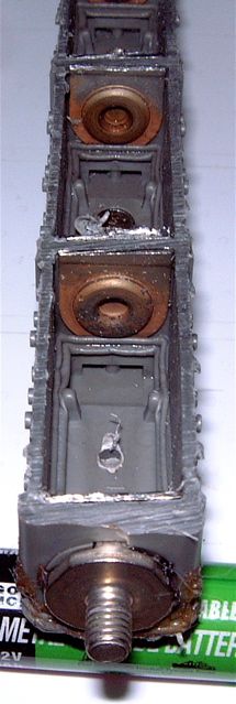

    The ordinary Prius use Nickel Metal Hydride (NiMH) chemistry for the main traction battery. The Plug-In Prius uses a massive LiON pack shown in the Toyota Dismantling Manual. My interest has been with the NiMH batteries.
    The NiMH battery works by converting between two nickel hydroxides and storing hydrogen atoms in the metal hydride:
    • Ni(OH){2} <=> NiO(OH) + H{2}O + e-
    • H{2}O + M + e- <=> OH- + MH
    What ages our NiMH batteries is the loss of H{2} and O{2} from the electrolyte.
    During normal charging, a small amount of water electrolyzes into H{2} and O{2} gas. Sealed, the metal hydride can recombine the H{2} and O{2} into water, a good thing. But the weak seals of the earliest 2001-03 battery modules could leak a little of the gas as they got hot and the gas pressure built up. Charging is the risk because it generates heat and gas pressure against the terminal seals:
    [​IMG] [​IMG]

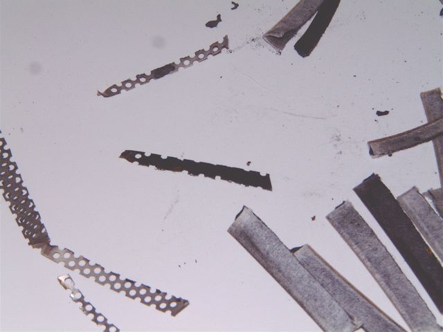

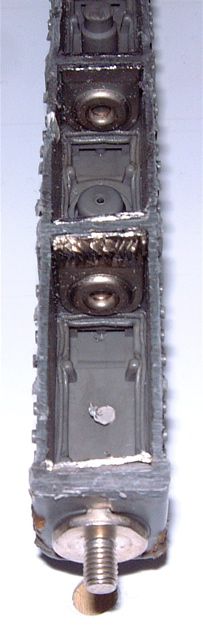

    The left photo shows rubber "O" ring is partially melted on the right side, the black smear. You can also see the nickel compound has changed color from the normal silvery color of the other electrode.
    Now as the H{2} and O{2} leak out, the electrolyte, a saturated solution of KOH, dries. This gradually reduces the conductive area in the plastic mesh separator, increasing the resistive heating to a smaller and smaller area. When the heat becomes hot enough to melt the separator, it forms an internal short and that cell is failed:
    But the melting doesn't happen instantly. First the reduced electrolyte increases the internal resistance of the cell. This reduces the capacity, the Ahr, and charge-discharge efficiency. So the obvious solution is to add water.

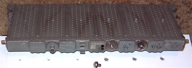

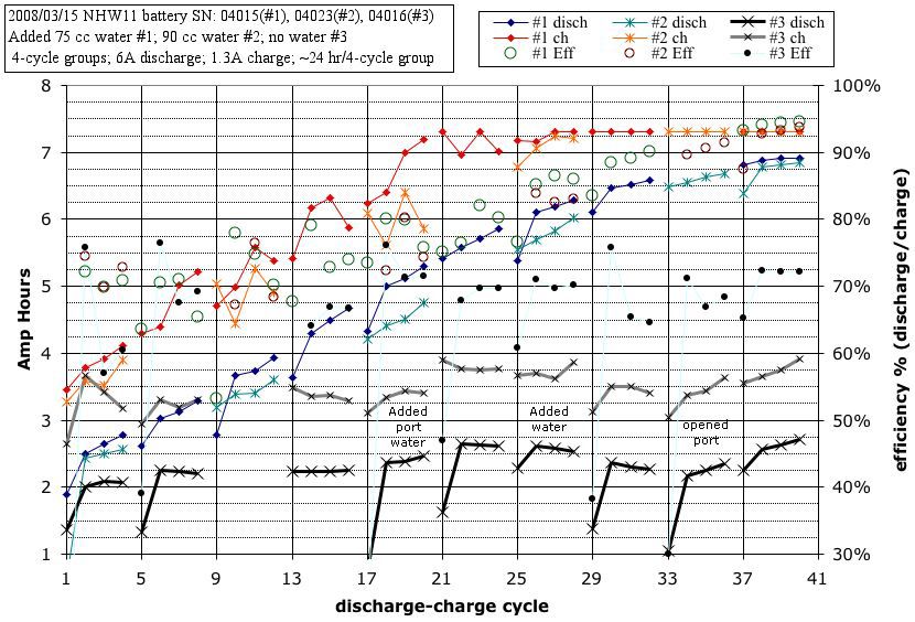

    There is an excellent Toyota-Panasonic patent on refreshing the electrolyte and some of us have tried different approaches:
    I have successfully returned full capacity to worn, battery modules by adding water and cycle charge-discharge . . . replicating the Toyota-Panasonic patent. But I sealing the modules turned out to be a problem.
    I tested stainless steel inserts and epoxy:
    The stainless steel nut plates even with heat did not form a gas-tight seal. Epoxy would not adhere to the plastic and the different thermal expansion rates would not be reliable either. I tried plastic welding like the Toyota-Panasonic patent only to realize we would have to use salvage case material and a mold fitting and still it would be marginal. But I could never figure out a solution for melted or weak "O" rings. So how does this relate to Prius efficiency?

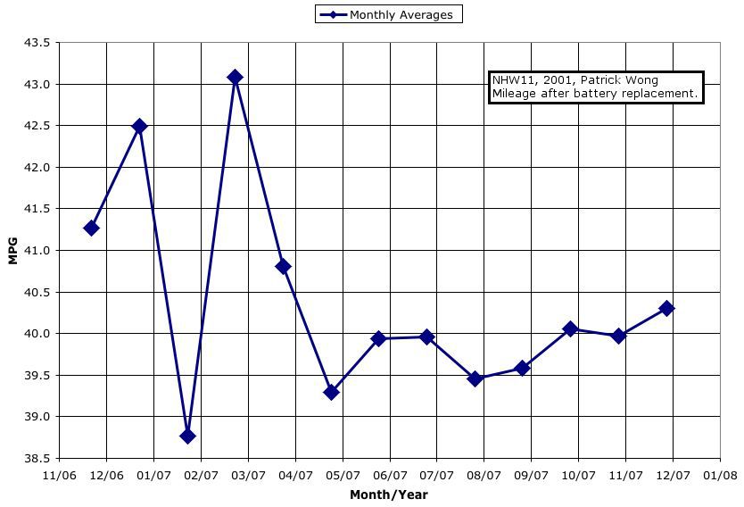

    Thanks to Patrick Wong, the early traction battery capacity loss occurs in the first 5-6 months:
    So unless someone is buying a new Prius or replaced the traction battery with a new one, this short interval really doesn't come into play. Most of the time, the Prius battery is only doing small, fractional charge-discharge cycles UNLESS the driver chooses to put a heavier load on the battery.

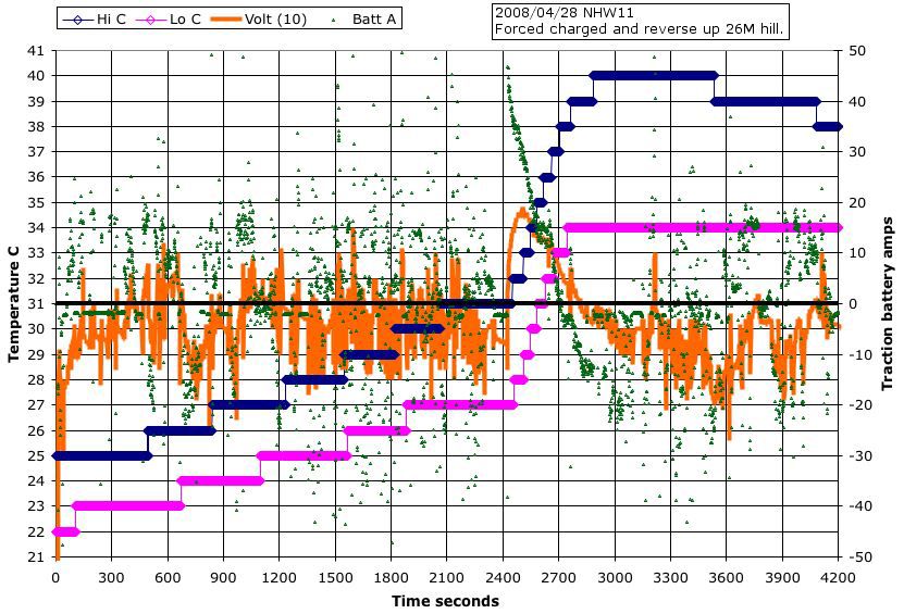

    Remember, charging is the risk:
    Here I am doing a forced charge recording the pack temperature. It generates:
    • heat - that weakens the "O" ring, terminal seal
    • gas - increases the pressure to leak it out
    The best path to a long battery life is to monitor the energy flow and AVOID battery discharge. So when climbing a hill, back-off when the energy flow shows a discharge. The same is true for acceleration, avoid drawing charge from the battery. If not discharged, the car won't have to charge the traction battery and heat it up. But sometime, we have to descend a large hill, 500 ft or so. In those cases, use "B" so the engine will absorb the excess energy that would over-charge and heat the traction battery. But this is just background information about our NiMH batteries: Prius Battery Photos

    This is an interesting thread. Under the assumption that heat is the battery killer, I have endeavored to limit the battery charge and discharge rate to 20 amps whenever possible. I noted that the controller usually limits the charge/discharge figure to about 22 amps. This is also true when one uses the "B" setting. So I figured that Toyota had determined that this was a good compromise between battery charge/discharge and heat generation. For me, this is a significant issue because I live in a very hilly area. It is not uncommon for me to see near an 80% charge at the bottom of a hill. Sometimes I will have to park the car with the battery in this highly charged condition. On a cold start in such cases, after a near full charge during the first phase of the warm-up period, if you allow it, it will run up to 100amps without engaging the ICE unless you push the power demand to the point where you force the engine to fire. My approach has been that, when the engine is cold, I limit the discharge to 20 amps until the controller starts applying ICE power to the wheels. Only then do I increase my power demand.
    Bob, your plot looks quite informative, but I am having trouble interpreting it because the legend is not clear to me. The orange line looks like it is plotting current with respect to time rather than volts as the legend implies, yes? Is the blue line percent charge?. If so, then are the green dots individual data points from multiple experimental runs in amps?
    gdanner likes this.

    Sorry, my graphs are often more for personal consumption but I share when I can:
    • dark-blue and pink - these are two temperature points in the battery
    • orange line is the voltage/10 - so the 34.6 peak is actually 346 volts
    • tiny-green dots - current using the right-size scale
    In this test, I wanted to find out high up a hill the car would go in reverse. But the hill was too small and a cop came by. Knowing the weight of the car and the change in altitude, I could calculate the available traction battery energy in kwHr.
