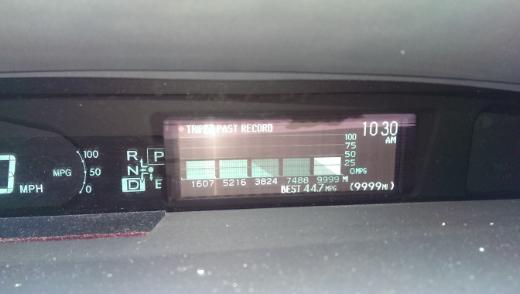

    Hi everyone. Our first post!
    We are considering buying a used Prius, solely because we need to reduce our gasoline expenses. We are seriously considering a specific one. Our budget is very tight, and we cannot afford to make a mistake.
    We have never owned a Prius, but have test driven a few used ones.
    The vehicle we are considering is a 2010 Prius (standard size). It has the IV package (nav, backup camera). It has solar panels and a sunroof. We will check carfax for any big problems. Price is blue book. It has about 115,000 miles, which is quite high. :eek: We can't afford a Gen III with low miles.
    We have two concerns about it. The first is that the car's mileage screen ("Trip Past Record") says the best trip was 44.7mpg (with trip lengths from 1500 - 9999 miles). Another screen showed the car attained 43.8mpg over the last 9999 miles. From what we have read, the mileage reported by the onboard Toyota computers are 2-8% over reality. If that's true, that puts it closer to 42-43mpg.
    Those mpg figures seem very low compared to what others get and what the EPA estimates, and we wonder if there is a problem with this particular Prius. Given that everything basically works, such a problem could be nearly impossible to diagnose and fix, even under warranty. The owner states she bought it new and uses it to drive across her large territory. She says she always keeps it in Eco mode and drives 55-65mph. Her territory consists of a hot moderately dry climate and she drives with the air conditioner on.
    The other issue is that when pressing the gas pedal from a stop (or low speeds), nothing happens for the first inch to inch and a half of pedal depression. After the "dead spot" or "lag", it works just fine. We came out of a parking lot, with oncoming traffic, and felt like we were going to get hit. Our experience was that we had to press the gas pedal at least 1/3 down to get any response. We experienced this in Normal and Eco mode, but less in Power mode. We know that these cars aren't too zippy from a standstill (which is surprising given the instant torque of the electrical motor), but it seemed like the first 1-1.5" of accelerator pedal depression had no effect. We don't recall experiencing this on the other Priuses that we test drove, but are not sure.
    What do you all think? Is it a dud, or no problem to buy?

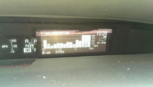

    It's hard to figure out what to do. The seller has all the service records from the Toyota dealership she uses. The tires are fairly new (we don't know what kind they are). There's also an extended warranty that's good until 125K (another 11-12K). She's asking $12,500. There are very few IIs and IIIs we could get for that, and most of them are high mileage, too. And we really like the sunroof and solar, plus the other perks of a IV. But we're worried we might get ourselves into trouble with this one and end up with major repair costs. If the seller is really driving gently in ECO mode, it doesn't make sense to us that it gets 44.7 mpg at the very best (which means other trips were less, if we understand the screen correctly). But we have an SUV currently, so it's still a huge improvement. We're just worried there's something mechanically wrong.
    Here are the screen shots she sent us. Are we interpreting them correctly?

    We added some pictures of the display output to one of our posts above.
    In regards to the financial side of it, we've created a budget and run the numbers, and it makes good sense for us if we can get it for $11K, given the very high mileage on the car. Not sure if the seller will do that.
    Our SUV, which runs great, gets 12-14 in the city, and 20 on the highway. We do a lot of city driving. We currently drive about 6-8K miles/year. We find we don't go on trips when we want because even a short trip is at least $20 in gas. We are hoping the Prius will give us a sense of more freedom to explore.
    We would like to steer this thread in the direction of whether the relatively low MPG (especially since it was always driven in ECO mode) and the throttle not responding until pressed about 1-1.5" (when stopped or going slowly) are indicative of potential problems that would require a pass on this particular vehicle.

    I would not worry too much about the past MPG by itself. It is in the normal range and MPG seems to depend more upon the nature of the driving (hills stops, speed, traffic, trip length) and the driving style of the driver rather than whether they are in Eco, Normal or Power mode.
    I would be concerned if I found out that the owner had only been getting that mpg doing long trips at moderate temperatures and moderate speeds with few stops and coasting to stop.
