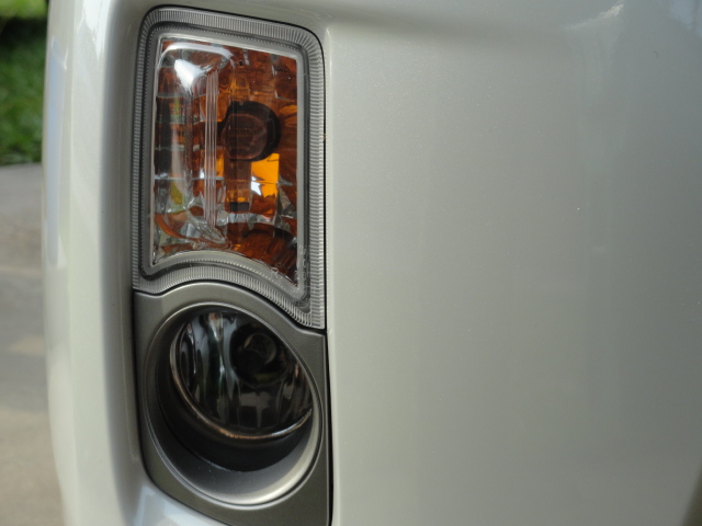

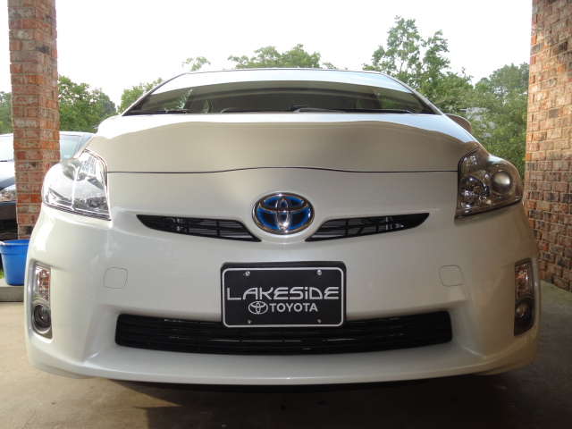

    Installed my Ebay fogs today so far so good.Really like the look the car has now.I have the DDM Tuning 5000k 35w HID kit in the headlights and reg bulbs in the fogs.

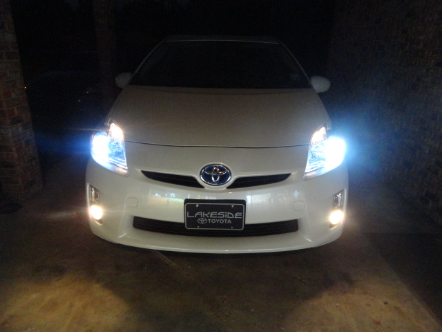

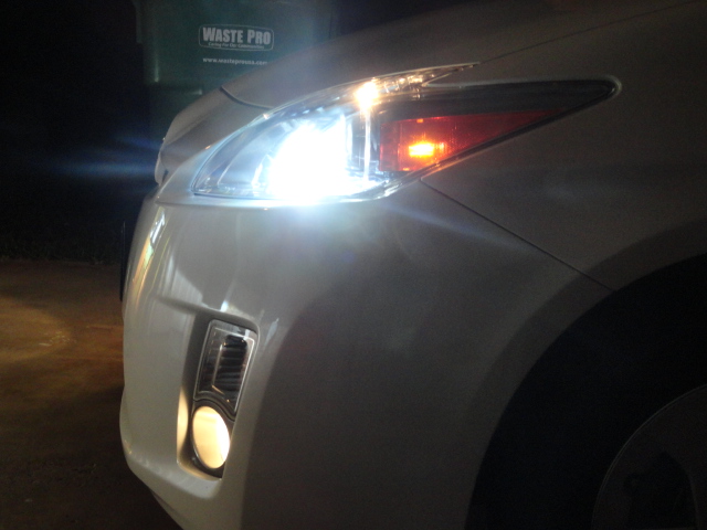

  3. John Bergendahl
    Jul 18, 2014
    102
    gulfport,ms
    Excuse the bright glare from the headlights,LOL camera and 5000k HID dont do well :)
    This combo looks really good at night in person.
    I had this same setup on my 2010 Altima 3.5 SR she was white also so i had to do this setup again .
    I agree with you totally,my altima didn't have projectors but it came stock with the HID's and they had no blinding effect.I guess it was a some special reg housing made for HID's
